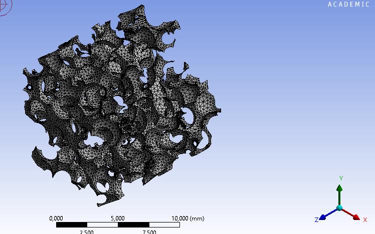

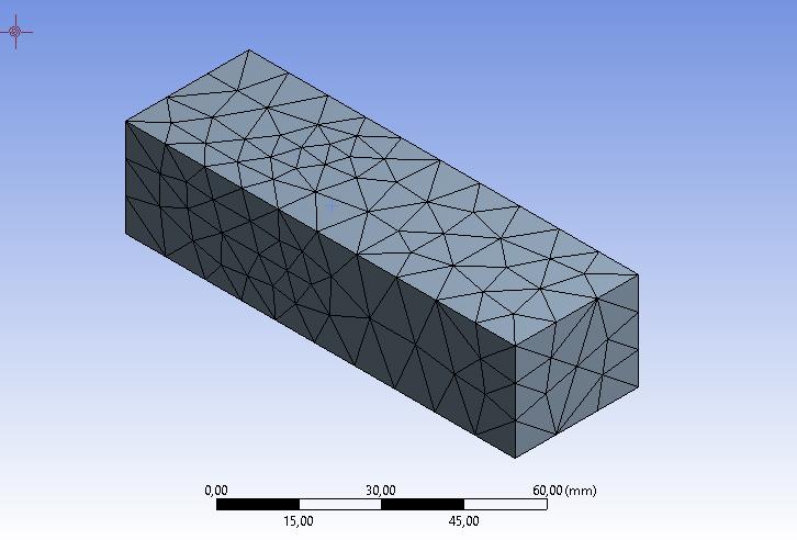

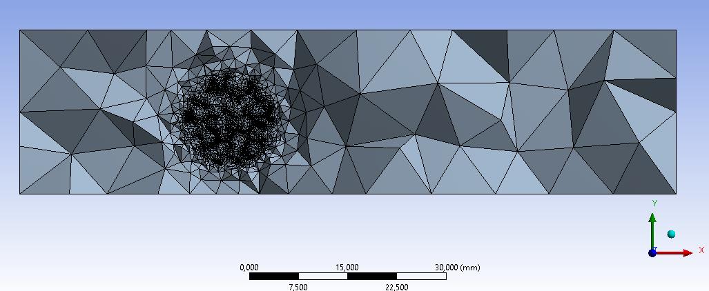

I'm doing a conjugate (thermal and fluid dynamic) study on a metal foam representative elemental volume (RVE) which would be placed on a fluid domain (air). The experiment consist on a heat flux placed on the bottom face (face whose normal vector has the same direction of -Z) and an air flow going forward on +X direction. The expected result is a conduction through the metal foam and convection between the foam and the air.
i'm using ANSYS academic version, that's the reason the mesh is the way it is.

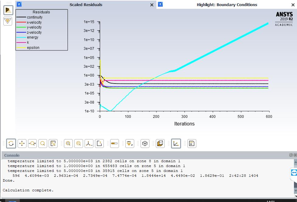

the model was Steady, Pressure-Based, Viscous (Realizable k-e), Energy On, the solution method used is Coupled.
the simulation was planified to calculate 2000 iterations but it clearly failed so i stopped the calculations.

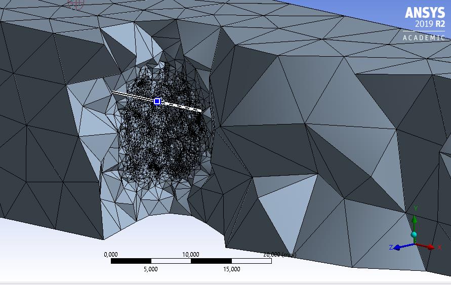

Forum ModeratorThe mesh is far too coarse in the main section of the channel: this needs to be refined. Also, how do you expect heat to get to the foam?Â

Subscriber.hi Nikopar10 how did sketch metal foam
December 24, 2021 at 11:47 am
Rob
Forum Moderator.It may be the result of a micro-CT scan or subtracting multiple randomly positioned spheres (bubbles) from a block.
