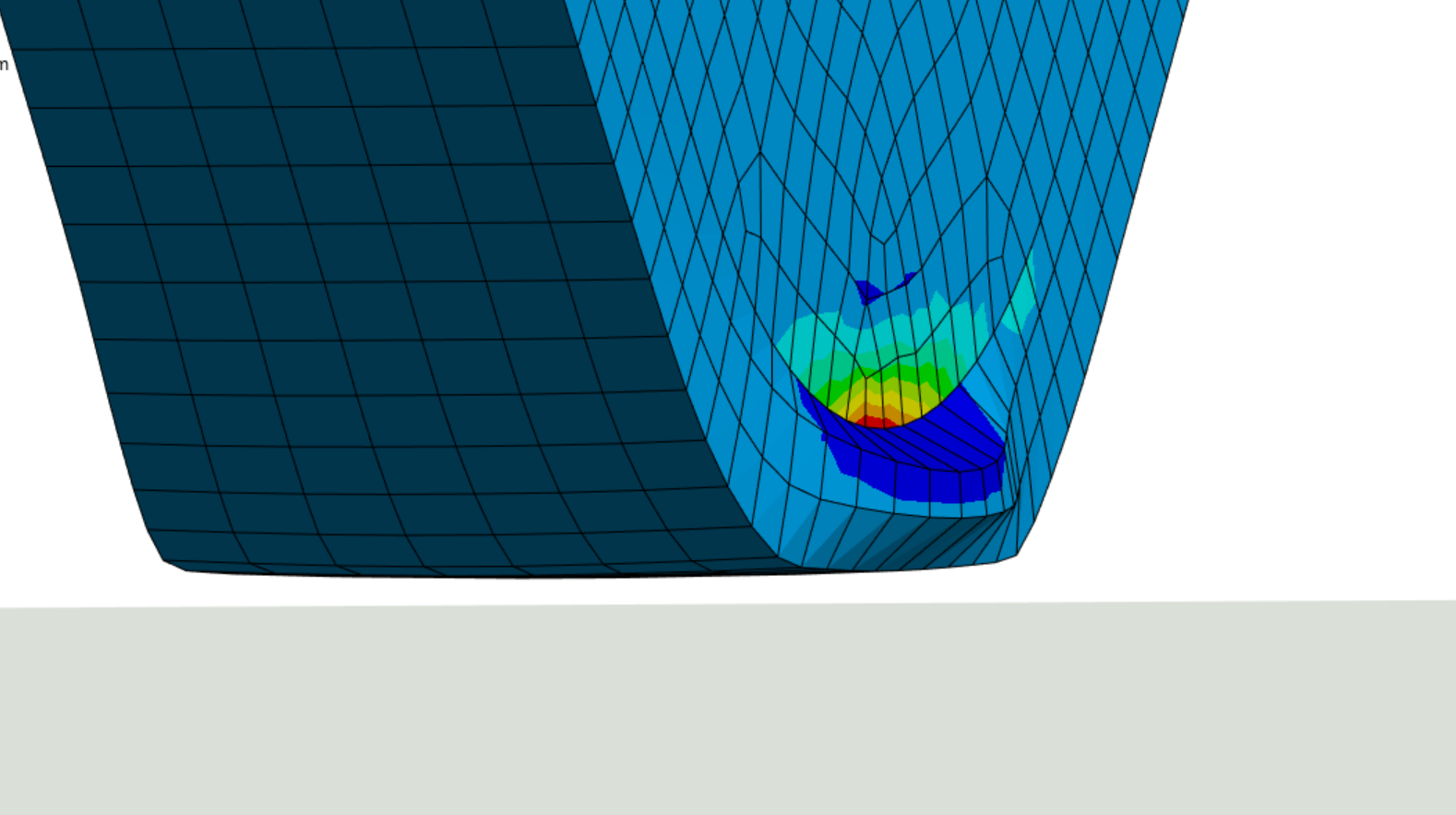

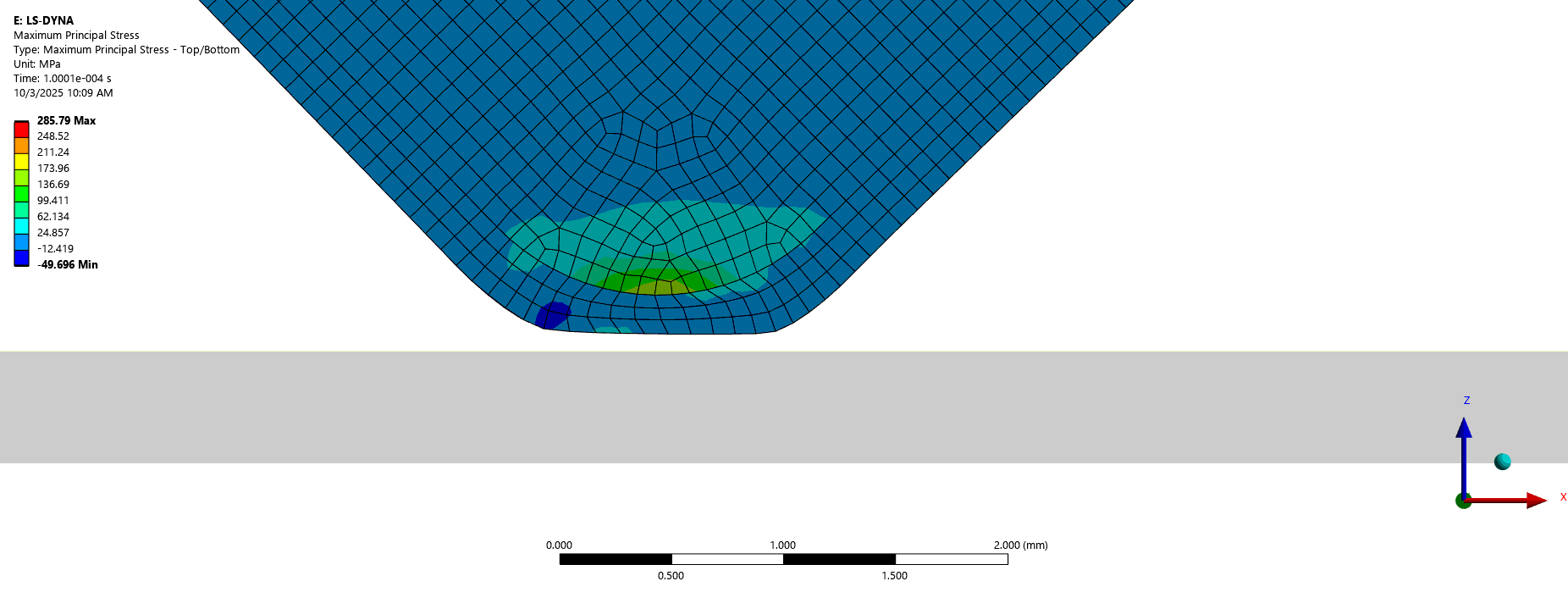

      I have a drop-impact simulation of a Glass+Plastic (polycarbonate) assembly. I'm get results that look like the Polycarbonate is undergoing plastic deformation.
      However, I have limited experience validating plastic deformation in LS-DYNA and would like some help on this. I'm especially worried if i've artificially introduced some non-physical plastic deformation in my attempts to eliminate Hourglass energy.

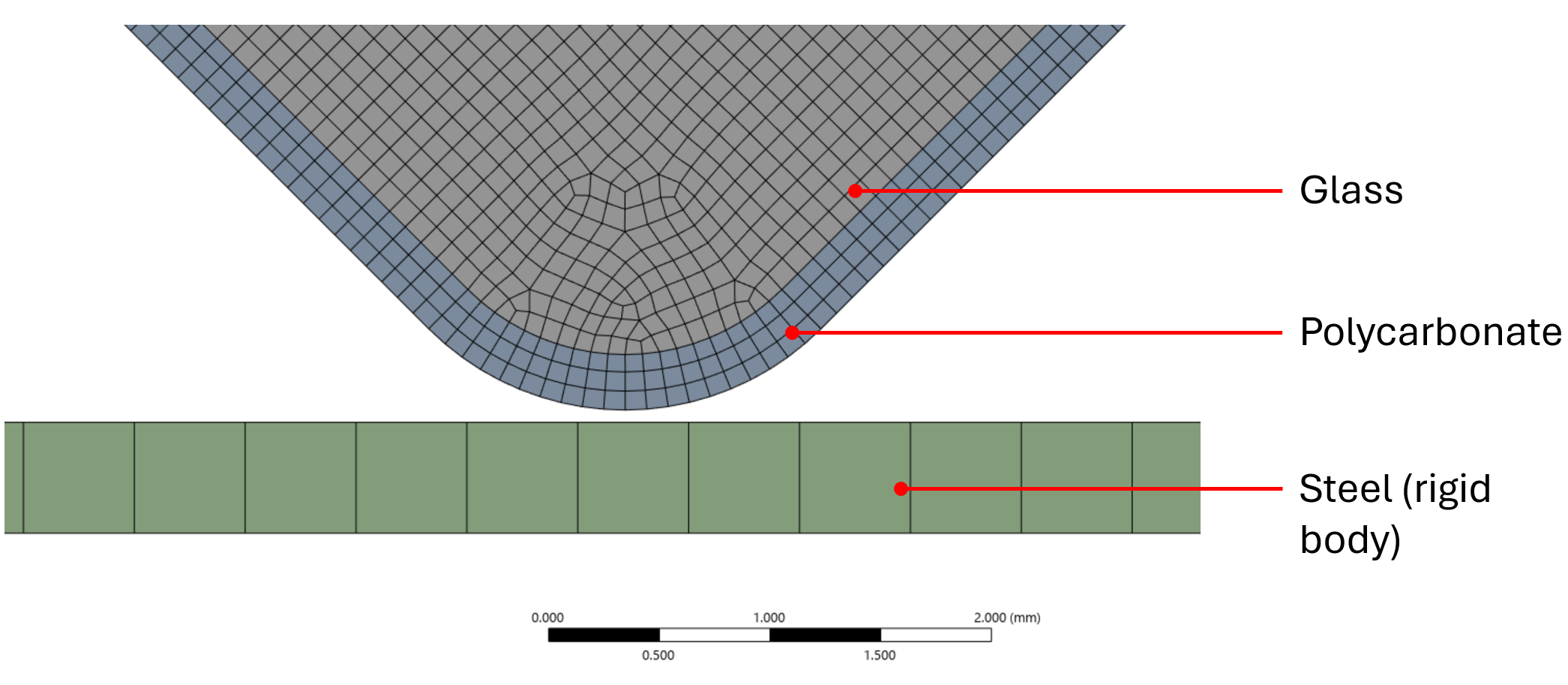

      Setup:
      • Materials: Glass - Proprietary (substrate) , Plastic, PC High viscosity - Ansys default library (around the glass perimeter) , Steel - Default library(rigid body- shell)
      • Contacts:
        • Glass <-> PC : Shared topology
        • PC <-> Plate : Frictional
          • Behavior: Asymmetric
          • Formulation: Pure Penalty (Automatic_nodes_to_surface)
          • Viscous damping coefficient: 0.1
          • Contact / Target Penalty Scale Factors: 10
          • Soft Constraint Formulations: Segment Based
          • Soft constraint Scale Factor: 1
          • Depth: 2
      • Mesh: Hex8 (for glass, PC), and Quad4 (plate)
      • Hourglass controls:
        • PC: ID 7 (Belytschko-Bindeman Linear Total Strain), coefficient = 1
      • Element Controls:
        • PC: Fully Integrated S/R Solid
      • Analysis setting:
        • Global Hourglass control: ID 5 (Exact Volume Flanagam-Belytschko Stiffness Form), coefficient = 0.1
      Points to note / Concerns:
      • High distortion of the PC (not sure how I can check this is actually physical/ potential mesh issue)
      • The contact energy increases and stays high (I think this is ok since there's sliding at the frictional interface)
      • Internal energy stays high after impact (again, I think this is physical since there's work done on the PC layer)
