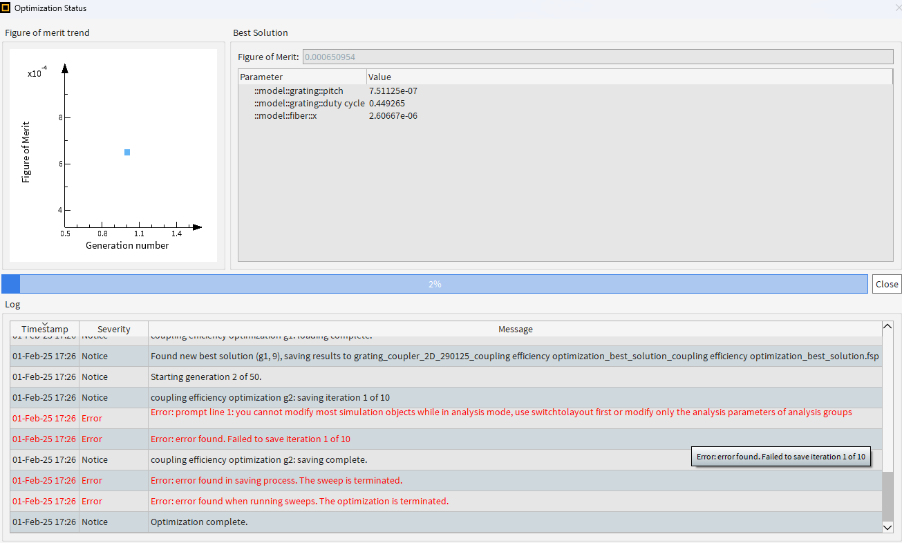

ive been trying to run the example simulation of the grating couplers - (https://optics.ansys.com/hc/en-us/articles/360042305334-Grating-coupler) when i try to run the 2D simulation in fdtd it works fine but then when i run the parameter sweep optimiziation whic supposed to get me the optimized pitch and duty cycle of the grating im getting the following error:
note that i did not change any parameters of the model objects and for the parameter sweep values, i just downloaded the example and ran it (first i ran the model itself and only then i ran the optimization parameter sweep) and the parameter sweep results conclude with this error after less than 5 minuets.
did someone encounter this?

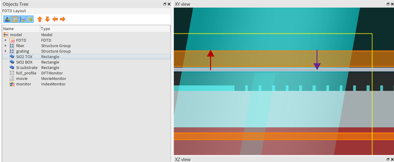

SubscriberFollow up question:
when i download the example the object tree looks as in the attached image:
it seems like there is no source in this simulation so im not sure what the 'monitor' supposed to detect if there is no light coming out through the fiber.
im clearly missing something here, would appreciate your help. thank you,

February 4, 2025 at 1:04 am
Kirill
Forum ModeratorDear Leroy,
- It looks like you're running the optimization while still in Analysis mode. Try switching back to Layout mode first.
- In this example, the Ports (FDTD) - Simulation Object is used, which serves as the source.

February 4, 2025 at 8:16 am
leroy.dok
SubscriberThank you very much for the fast response.
i did ran it in analysis mode by mistake - i fixed it.
