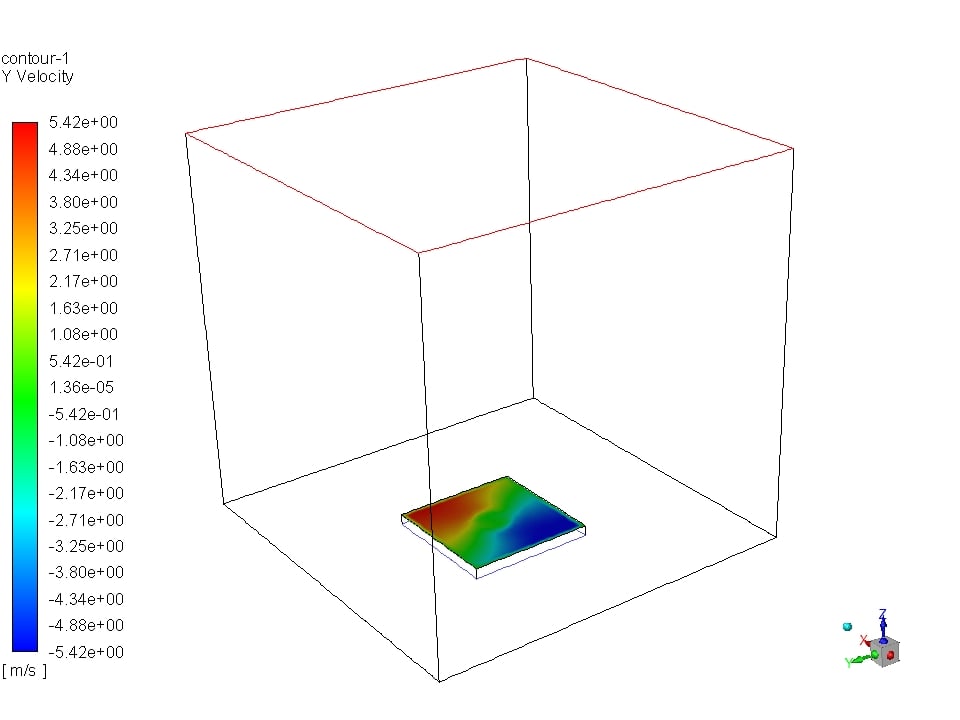

      I am trying to define a 2-D fan model using the fan boundary condition on a square surface in a 3-D simulation of a room. Eventually, I would like to introduce a tangential velocity profile as a function of radius as instructed in the user guide. However, I am puzzled by how Fluent interprets the tangential velocity since the tangential velocity I get as a result is always less than what I input. Even when I try constant tangential velocity value the resultant tangential velocity seems to be at least factor of 2 less than what I defined as shown in the figure.
      I'll greatly appreciate your help in clarifying how Fluent uses inputs for tangential velocity? Why don't I see the tangential velocity imposed between the hub radius and outer dimension of the boundary surface as I define?

      you're looking at the velocity in the x direction, and if I am correct I believe that doesn't represent the tangential velocity. I think you will find the tangential velocity is the combination of both x and y velocity sqrt(Vx^2 + Vy^2).

      You're viewing the x-velocity component as Raef says.  Either change the cell zone reference to the fan axis (gives you tangential, axial & circumferential velocity contours directly in Fluent) or write a custom field function to do the same, again as Raef mentions: remember to apply any off set for the origin.

      Thanks for quick response. I was actually aware that I printed x velocity contours. Even if I look at the x velocity I was intuitively expecting to see a value close to what I specified. Y velocity contour is sort of 90-deg rotated version of this. Even if you compute sqrt(Vx^2 + Vy^2) you don't get any values close to the input value.
      Below are the contours for tangential velocity. I'm not sure if this is the right way to present tangential velocity contour. Perhaps, I'm wrong but I still expect to see values somewhere in the contour close to my input value.
      Your input tangential velocity is based on the fan axis & origin.  Your post processed velocity is based on the fluid coordinate which is has an origin of 0, 0, 0 and axis in +z by default.
      Open the cell zone panel and click Help: you're looking for the section on specifying the rotation axis.

      Thank you for helping me figure out how to plot the tangential velocity based on fan axis and origin.
      Below is the updated tangential velocity contour.
      However, I still cannot explain the difference between the maximum values in this contour plot and my input.

      I used a milder constant tangential velocity (1 m/s instead of 13.74 m/s initially) this time. According to the plot of tangential velocity as a function of y direction along the midline of the fan surface, the values plateaued at around 0.5 m/s outside hub (half of the input). How should I interpret this?

      Fluent post processing does not report the specified tangential velocity on the fan bc panel. The post processor computes the tangential velocity from local cell conditions using the axis and origin defined in the cell zone panel. However, the tangential velocity specified in the boundary condition panel is used to introduce swirl in the flow by the fan model in the solver. The extent of the introduced swirl in the flow is determined by the difference of the specified swirl (tangential/radial velocity components) and the flow conditions encountered by the fan model. This in general will not give you exactly the imposed value but values in the vicinity of the specified swirl.

      Yes, the fan BC in Fluent seems to impose the tangential velocity within the first cell downstream of the fan. Since I was looking at the immediate surface where the fan bc is, I was reading values lower than the imposed tangential velocity.
