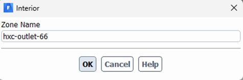

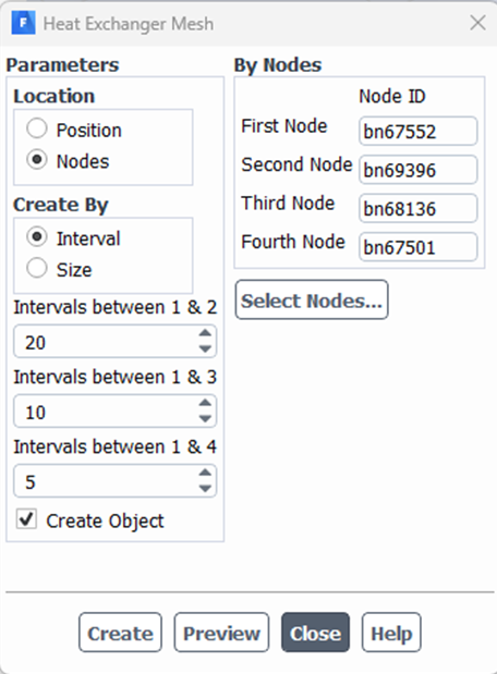

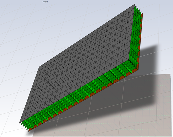

Subscriberhii, im using this interface in fluent to create an heat exchanger mesh --> create --> heat echanger mesh:

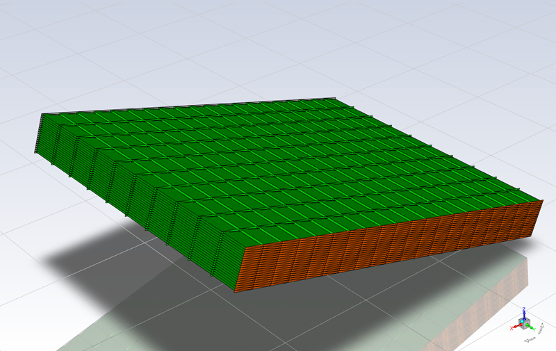

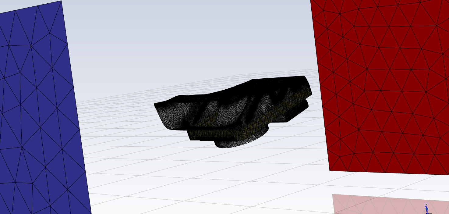

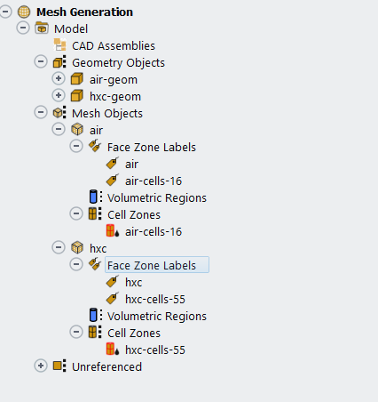

i have to use the dual cell method, so basically i'm realazing 2 meshes that actually are the same, but with 2 different inlet and outlet, and internal shape. the first mesh is for the air and the second for the hxc
but i don't know if this method is right or not, and also i don't know how to manage this interface

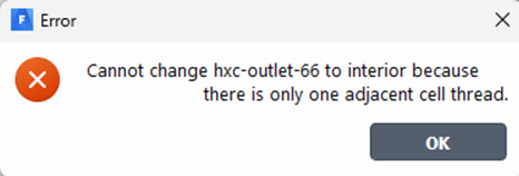

because every time i switch to solution i also have this kind of error:
but when i go to the boundary condition is working as interior
this is my full modelÂ

Ansys EmployeePlease user type 'interface' instead of interior. Then please use non conformal interface approach in Fluent.Â
Please go through help manual for more detailsÂ
