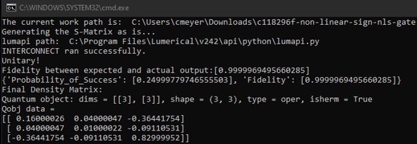

Ansys EmployeeRunning qINTERCONNECT from INTERCONNECT platform
- Download NLS_ideal.py and NLS_ideal.icp from Non-Linear Sign (NLS) Gate – Ansys OpticsÂ
- Start the Optics LauncherÂ
- Click New Project from the INTERCONNECT Photonic Integrated Circuit Solver line.
- Open the Script File EditorÂ
- Click Open script then browse to NLS_ideal.py, or simply drag and drop the python file in the editor. Â
- Click Run script.
   7. A command prompt window shows the calculation of a qubit gate with probability rate of 25% using only classical gates.
November 15, 2024 at 12:44 am
November 15, 2024 at 12:59 am
venuskd
SubscriberI did all steps,
Although, I did not face python integration configuration.
And this is the result:
So it seems I have access via Interconnect, but directly from python it does not work.
I am using Spyder to run my codes, as I mentioend earlier I did FDTD simulartions via python API, and it worked with no issue! but I do not know why for qInterconnect I see this: ModuleNotFoundError: No module named 'qinterconnect.solver'
