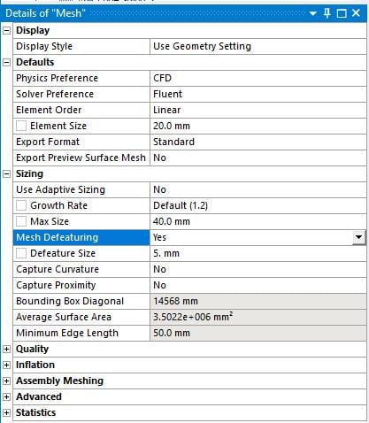

You can see how a coarse mesh looks like on this geometry. Delete (or Suppress) all items under Mesh. Select all the faces of the bumpy object and use a Mesh Sizing on those faces of 5 mm.
Set the Mesh to Defeature objects of 5 mm or less. Turn off Adaptive Meshing and set the Element Size to 20 mm.

SubscriberHow did the bumpy solid look like at that mesh setting? Was it too coarse? Can you simulate a smaller domain?
I suggest you just run the airflow in the air domain only, and leave out the solid material for a first test. You can use the same settings.
You want Shared Topology when you create the air so that there is no contact needed between the solid and air.
