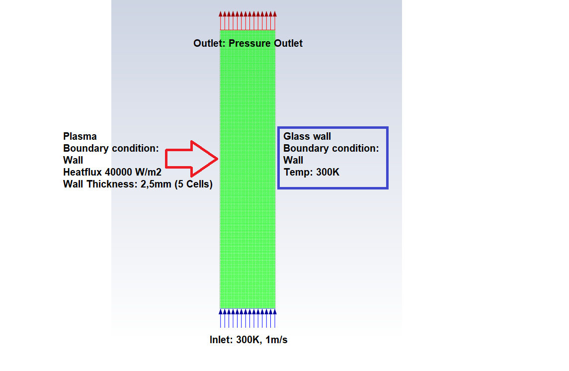

      Background:
      I am trying to simulate a plasma reactor to map heat distribution and airflow. This is a basic 2D simulation and I started with the a fluid domain only and got the result I liked . See two pictures below. Note: the model represents only half of the reactor but I did not select Axis-symmetry.

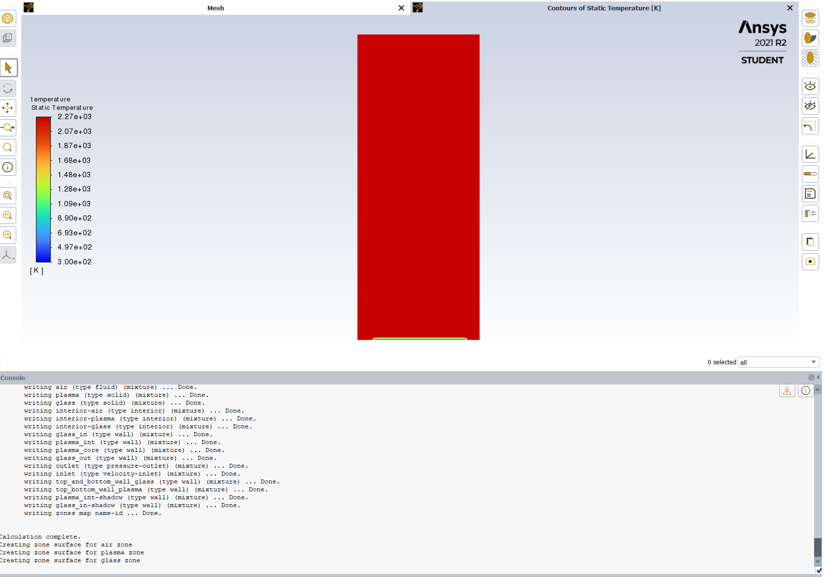

      I'm thinking that you missed the Share Topology step in your geometry preparation. When you perform this, Fluent will automatically recognize convert the solid-fluid wall as coupled. Perhaps, this is what you are looking for Karthik
    • Randy92
      thank you for your answer. Unfortunately this does not help. The calculation is still finished immediately this can┬┤t be correct.
