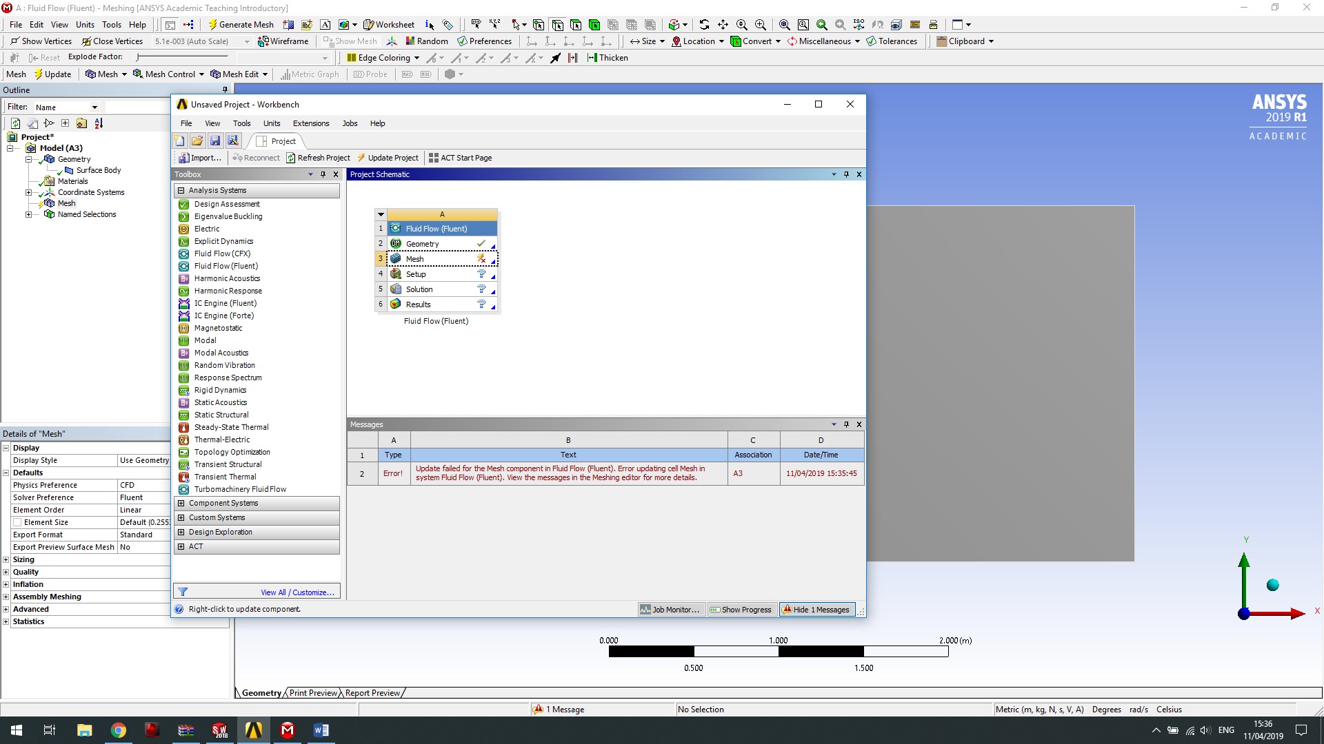

      Been trying to do my dissertation, and to say the least it has been unsuccessful due to Ansys issues.

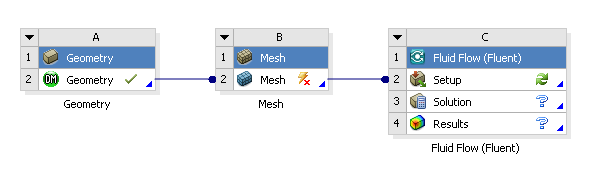

      -When trying to use Ansys Fluent, I have imported a .IGS file into designmoduler, and it successfully manages to update.
      -Importing it into the designmoduler to create a Mesh, I run into problems.
      1) I cannot use the drop menu when I right click anywhere. For example, I cannot select named selection, when I right click, as that button will not function. The same goes for multiple different buttons, such as when I right click mesh and select Generate.

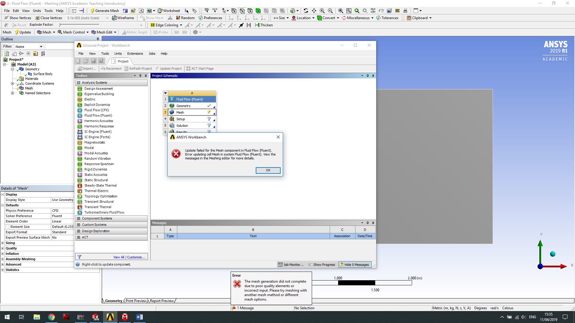

      2) When the setup is default, and nothing has been changed, no named selections etc. the mesh will not generate, and an error message appears:
      "Update failed for the Mesh component in Fluid Flow (Fluent). Error updating cell Mesh in system Fluid Flow (Fluent). View the messages in the Meshing editor for more details"

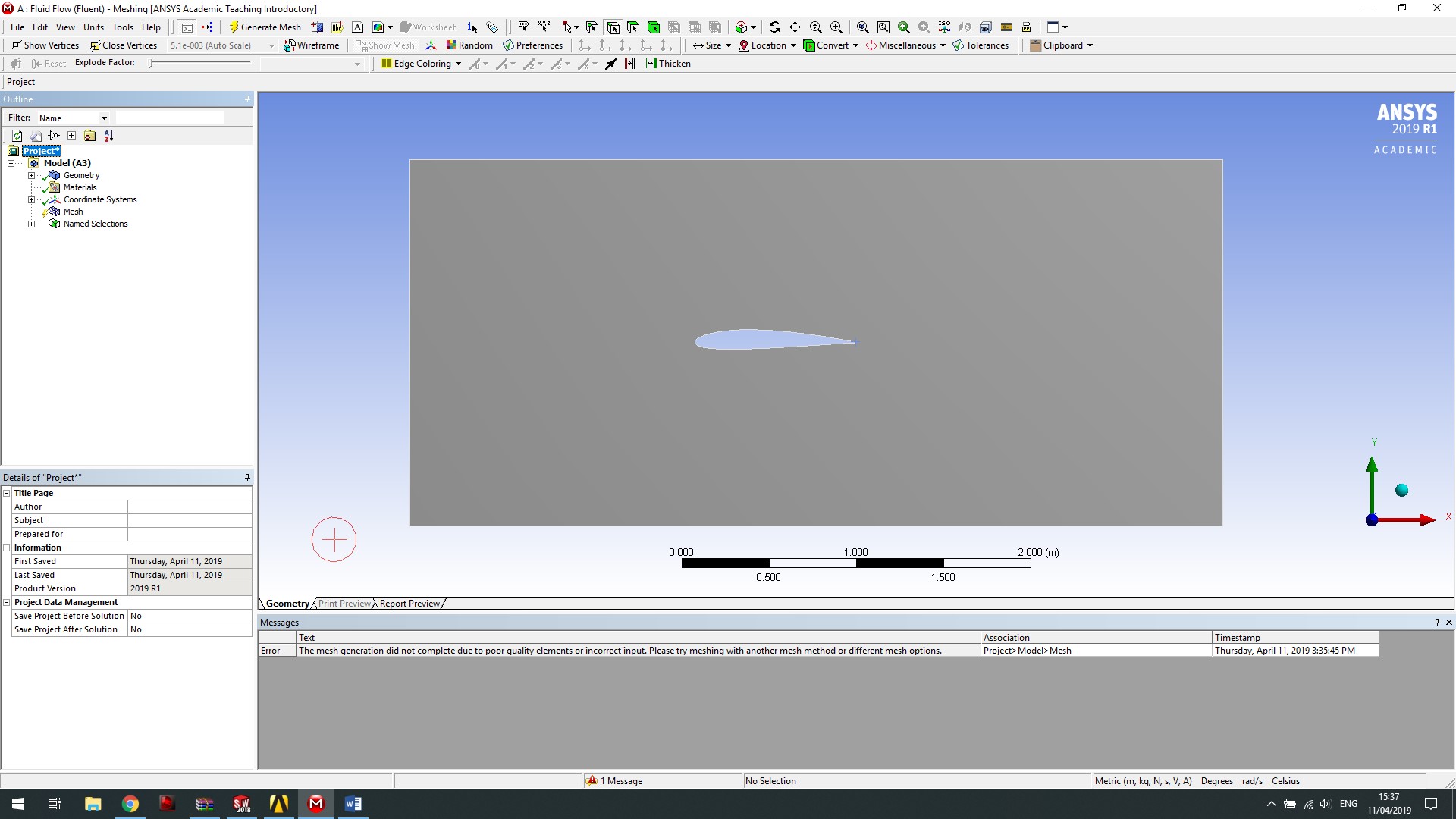

      The error message within the Meshing Editor:
      "The mesh generation did not complete due to poor quality elements or incorrect input. Please try meshing with another mesh method or different mesh options"

      Did you set the geometry to be 2d before you imported the CAD?  Right-click on geometry & click properties.
    • JamieRayment
      The geometry that was created was a 2D planar surface, that was a single body, and exported from Solidworks. Have now re-installed windows, and Ansys is working with the exact same model, so I still think it was a software error. Thanks for the reply.

      It is neither a software error nor a meshing error. Maybe you have forgotten to do boolean operation (unite, subtract) in the design modeller or space claim.
