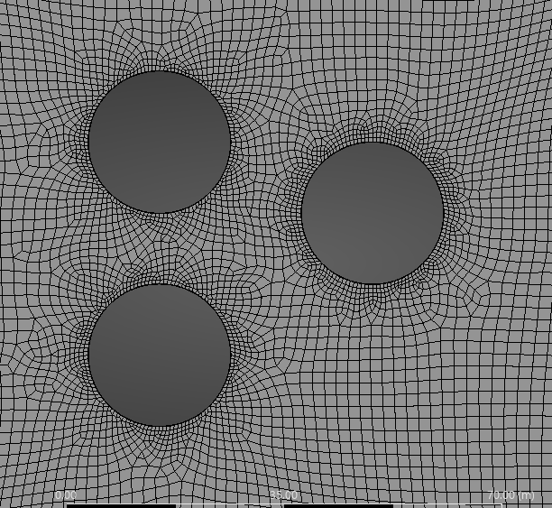

      Hello! I am trying to model the flow of air over 3 2D cylinders (75ft in diameter each) in this configuration. I am quite new to Fluent and need some help sizing my mesh so that I get a structured topology. Could someone please advise me on whether this is a geometric issue or a meshing issue? Thank you.
      Don't. Remove the decomposition and use inflation plus hex pave mesh. All a map mesh is going to acheive is wasted, possibly skew cells. Fluent is an unstructured solver so even a fully (sub)map mesh won't be treated differently to a hex pave in numerical terms.
      Your priority is radial and inflation resolution followed by the wake region.

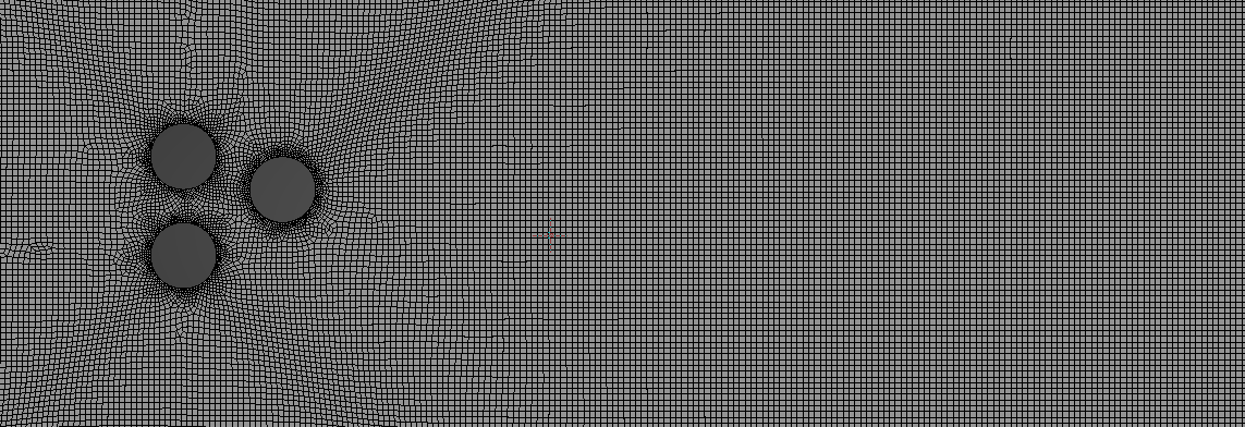

        Also, I tried taking your advice and implemented edge sizing + face sizing + inflation (120 edge divisions around the cylinders, 2m element size for the face, first layer height of 0.0004m, max layers=20, and growth rate=1.2). Below is my mesh. Is this good enough?
