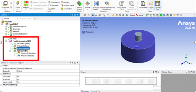

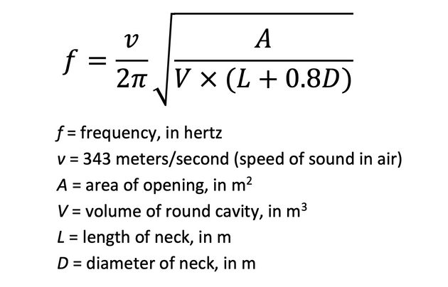

      I want to calculate hemholtz resonance frequency and compare it with the formula below. I have some question related to this problem.
      1. Which analysis should I use? Modal Acoustic or Harmonic Acoustic?
      2. Which body should be defiend as an Acoustic Region? Neck or Cavity?
      3. What boundry coniditions should I apply? Pressure and ..?

      Try using a modal analysis. Define Cavity as the Acoustic Region. I think you do not need to apply any b.c. The modal analysis will give you the natural frequencies of vibration for the cavity.

      When I define only cavity as the acoustic region, I got this.
      I have to choose both cavity and neck as the acoustic regions in order to get result.
      Moreover, when I don't apply pressure I get different frequency from the formula.
      regards.
