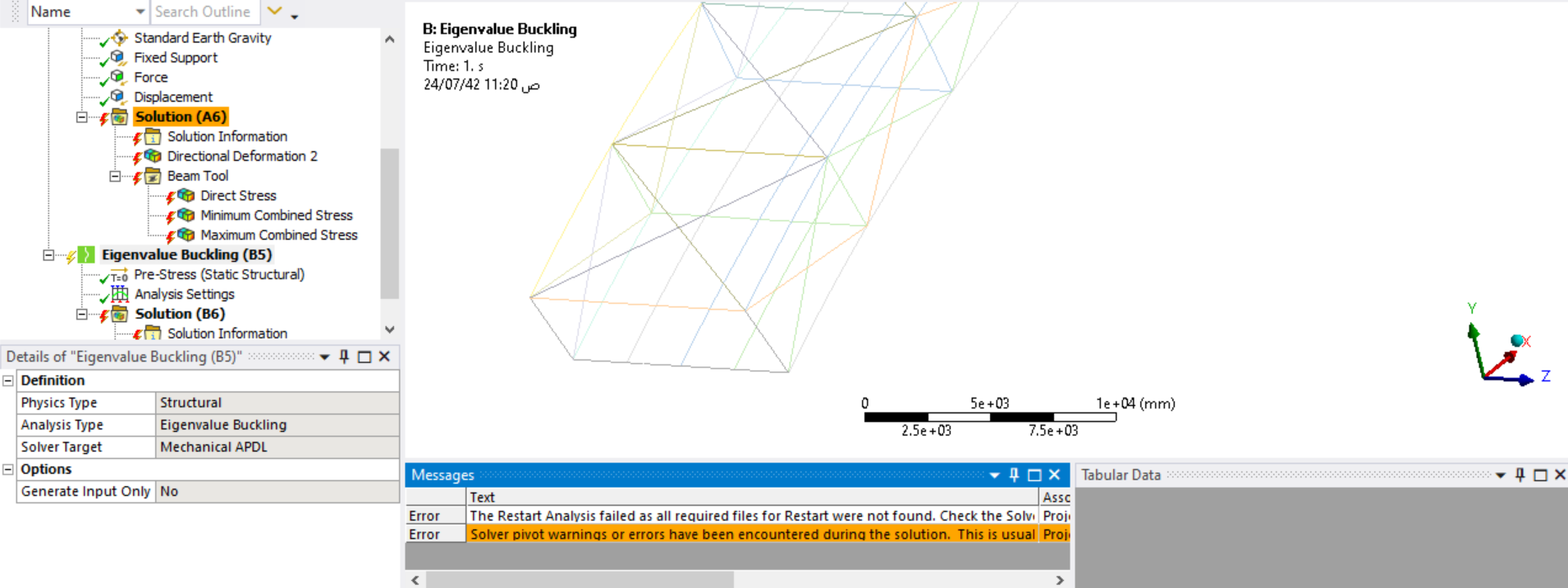

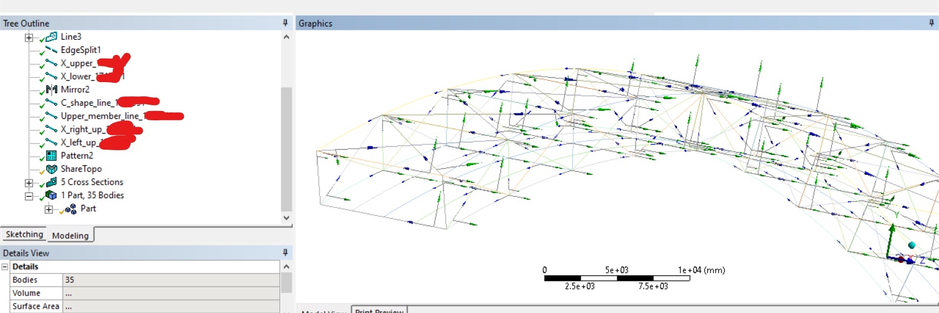

SubscriberI designed a truss structure when I put the fixed support on the line and displacement on the other side it did not solve and it gave me an error pivot so what should I do? n -

Ansys EmployeeGood MorningnnMake sure you have only one truss element per linebody, otherwise it is singular. Also make sure that it is restrained OK.nSee this tutorial for details and for the above mentioned:https://www.youtube.com/watch?v=yEiIJcBnq3wnnAll the bestnErikn -
