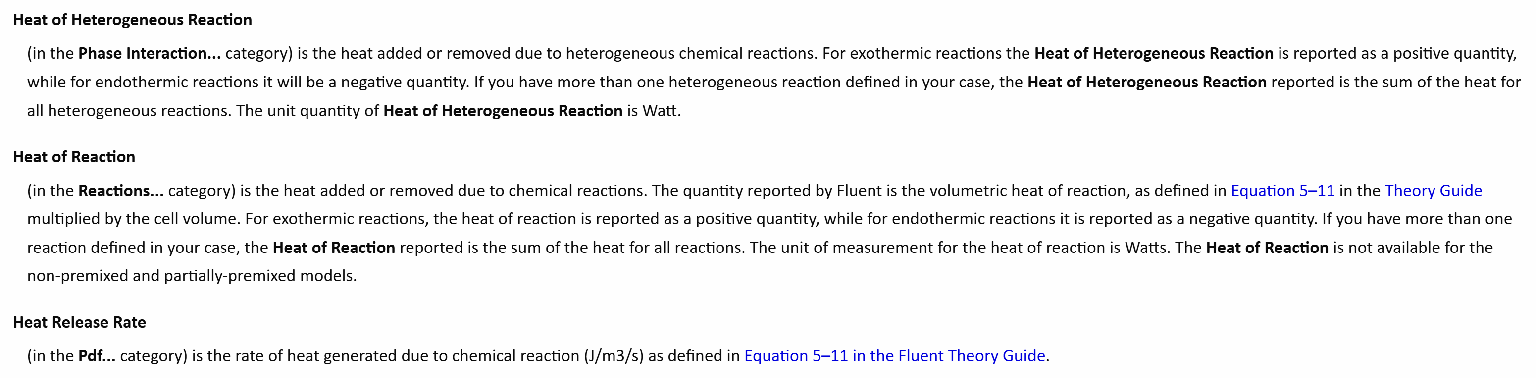

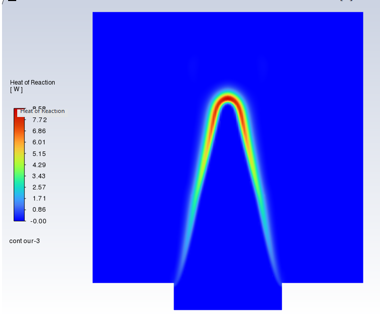

      I simulated a steady laminar premixed flame, to be used as an initial guess for my transient equivalence ratio and velocity fluctuations.
      I need help to know and plot the heat release rate, as I only find the heat of reaction in the contours
      I attached the steady state heat of reaction and sample of the oscillations
      thank you for your time
    • Essence
      Please refer Ansys guide.
      https://ansyshelp.ansys.com/account/secured?returnurl=/Views/Secured/corp/v251/en/flu_ug/flu_ug_fvdefs.html?q=Alphabetical%20Listing%20of%20Field%20Variables
