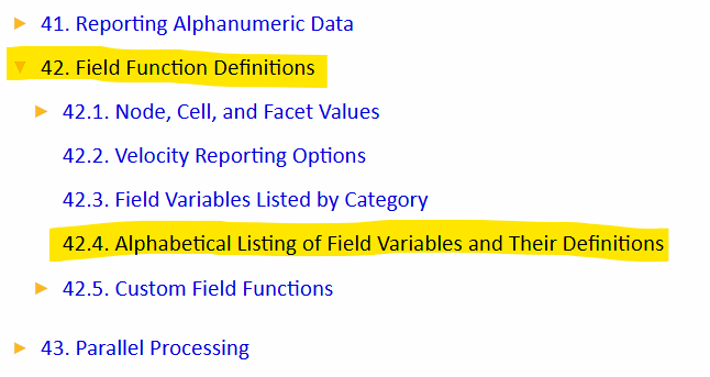

    • hamzaelgarf12
      can you tell me where can i find this screenshot?
    • Ren
      Fluent has a dedicated chapter providing the definitions of all field functions:
      Please note that the chapter number may be different from what is shown here. It depends on the product release number.
