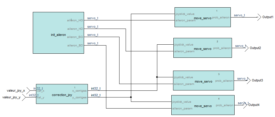

SubscriberHow do I use the types defined in stdint.h in my models ? Do i have to import them ? If so how do I procede.

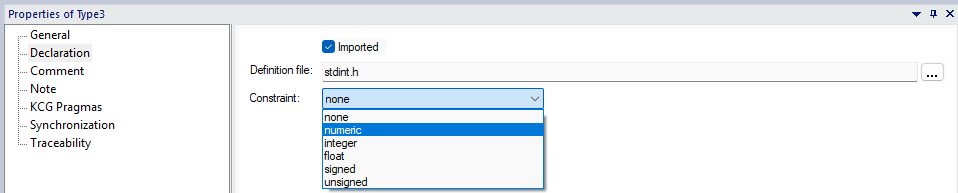

To use external definitions (whatever it concerns types, constants or functions), you should use imported code.
As example, you can define a new type and declare it as imported. In the Properties, you can select the Definition file that provides its C definition. Finally, you could define some constraints on this type, expecially if it is a numeric type (useful to allow use of mathematical Scade functions for example):

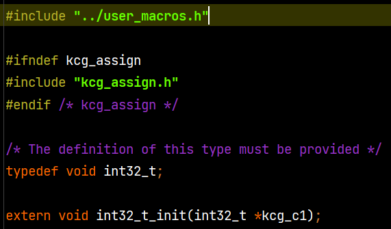

Use of imported types introduces some constraints. You must also provide:
- an init function for KCG
- copy and comp functions

The init function is required to define behavior for initialization. Example:
void int32_t_init(int32_t *kcg_c1)
  *kcg_c1= 0;
}This is the minimum required to generate code with KCG.

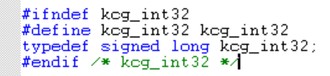

For numeric types, I will rather recommend you to use the native types of the Scade language (integr/float types of the Scade language). For mapping with the C types, you have possibility to map implementation of these numeric types with definition of your stdint.h library. As example, KCG generates the following default definition:
You can the provide your own definition of the macro kcg_int32 and map it to definition of stdint.h.
It could be a way to avoid use of imported types in your Scade model.
