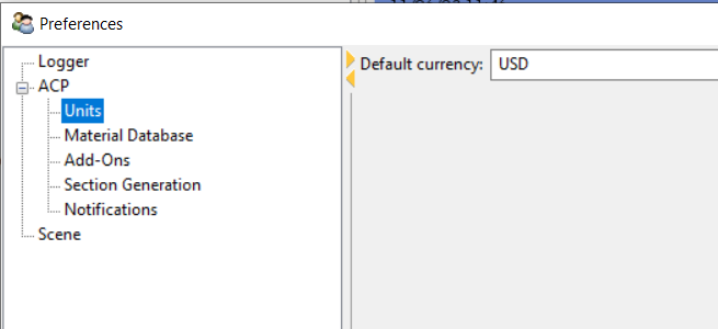

      SOLVED
      If the default currency in the preferences is not on USD, the error occurs.
      With changing it back(?, was on MPA) to USD everything works fine.

    • Shahab Azimi
      Same issue in 2023R1, but I cannot see the currency unit in Preference. The unit system is set to MPA.
    • Reno Genest
      Hello Shahab,
      You  should be able to see the currency unit in Tools > Preferences:
      Reno.
    • Shahab Azimi
      Thanks
