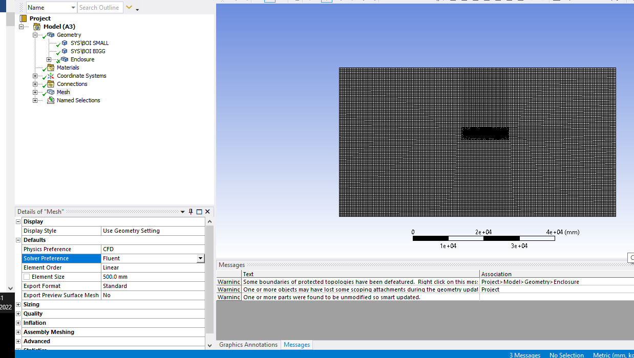

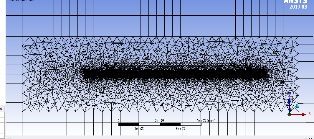

    • tumulpurwar
    • tumulpurwar
    • tumulpurwar

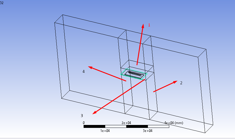

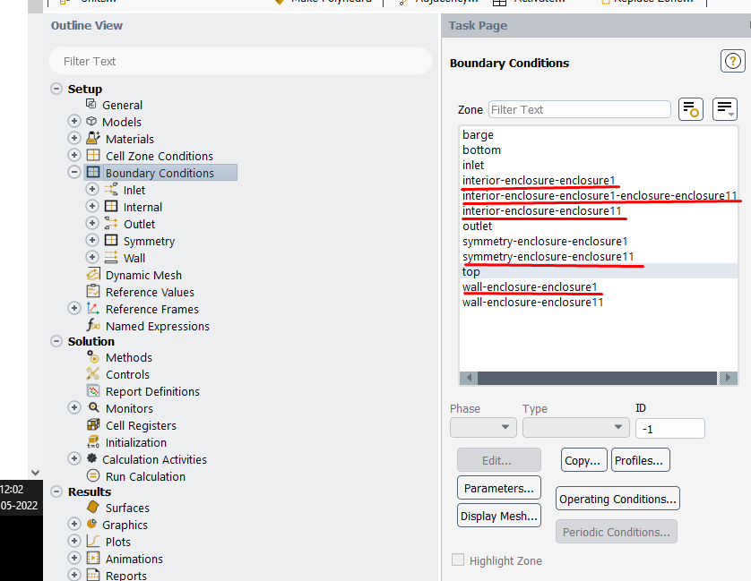

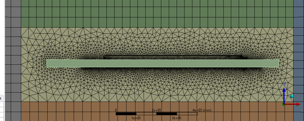

      Hi peteroznewman
      If i follow your advice of splitting fluid domain to get sweeping of mesh..everything go fine..but i get surfaces where i make split in fluid doamin, when i go to fluent, in boundary condition menu, these all surfaces come, and than there they want to be define with wall, or symmetry or inlet or outlet etc...how i do split in spaceclaim, so that i dont get theses surfaces?
    • tumulpurwar
    • tumulpurwar
      My extra generated boundary conditions due to split surfaces
      tumi
      In SpaceClaim, on the Workbench tab, use the Share button. That prevents lots of walls in Fluent.
