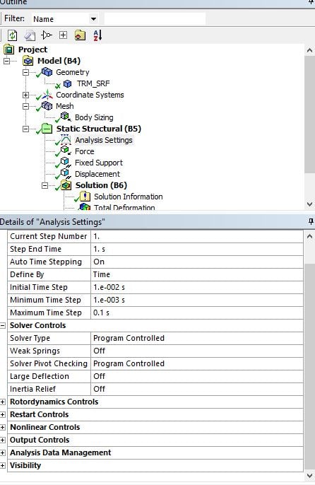

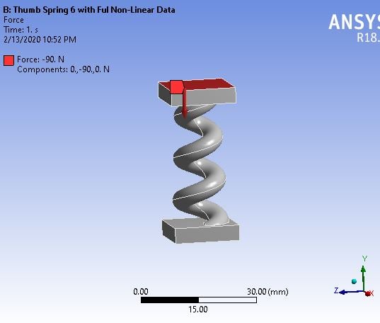

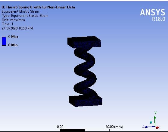

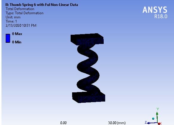

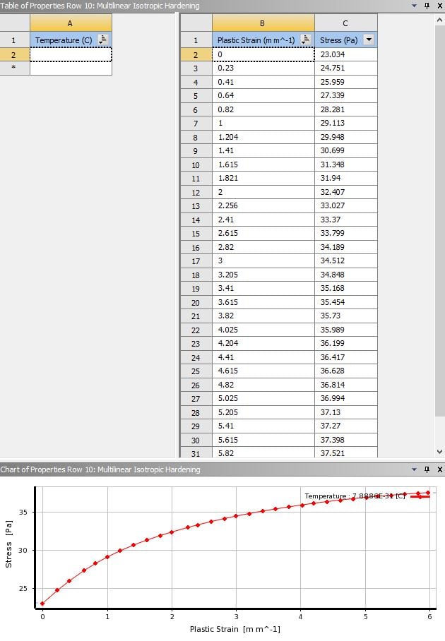

      I am simulating spring in static structural with non-linear data but the ANSYS does not converge even for a single point and abruptly stop the ANSYS unsolve result. However, I tried to put full the non-linear stress-strain data ( True Stress-Strain Data)  from Yielding to Ultimate Strength but still not result. Please have a look at the Pictures. Also, I have tried with both mentioned below non-linear data but no result.
      Boundaries :
      1: Force
      2:Fixed Support
      3: Displacement ( Restrained in X, Z and only free in Y-axis)

      Yes, I got your point but basically this geometry is about like a cone not like what you thought about. We can not do what you mentioned because it is gradually decreasing or increase the spring diameter and constant at one end.  More clearly, before I have simulated successfully the same spring with the non-linear data but now I am facing this problem because of the decrease in the Stress-Strain points in the non-linear data.
      Summing up: My query is why the simulation is not going to succeed when we decrease the Stress-Strain Points?

      A model that has Plasticity as you have made, and also has a Force input can fail to converge before the full Force is applied simply because the material cannot support the full Force.
      This is easily proven by changing the load from a Force to a Displacement. Now you can plot the Force Reaction on that displacement and you will see the force increase linearly, then a curve develops and eventually, the curve flattens. The point when the force-displacement curve has a zero slope, that is the failure load.  If that failure load is less that the full Force, that explains why a model with a Force input is going to fail to converge before reaching the full Force.
