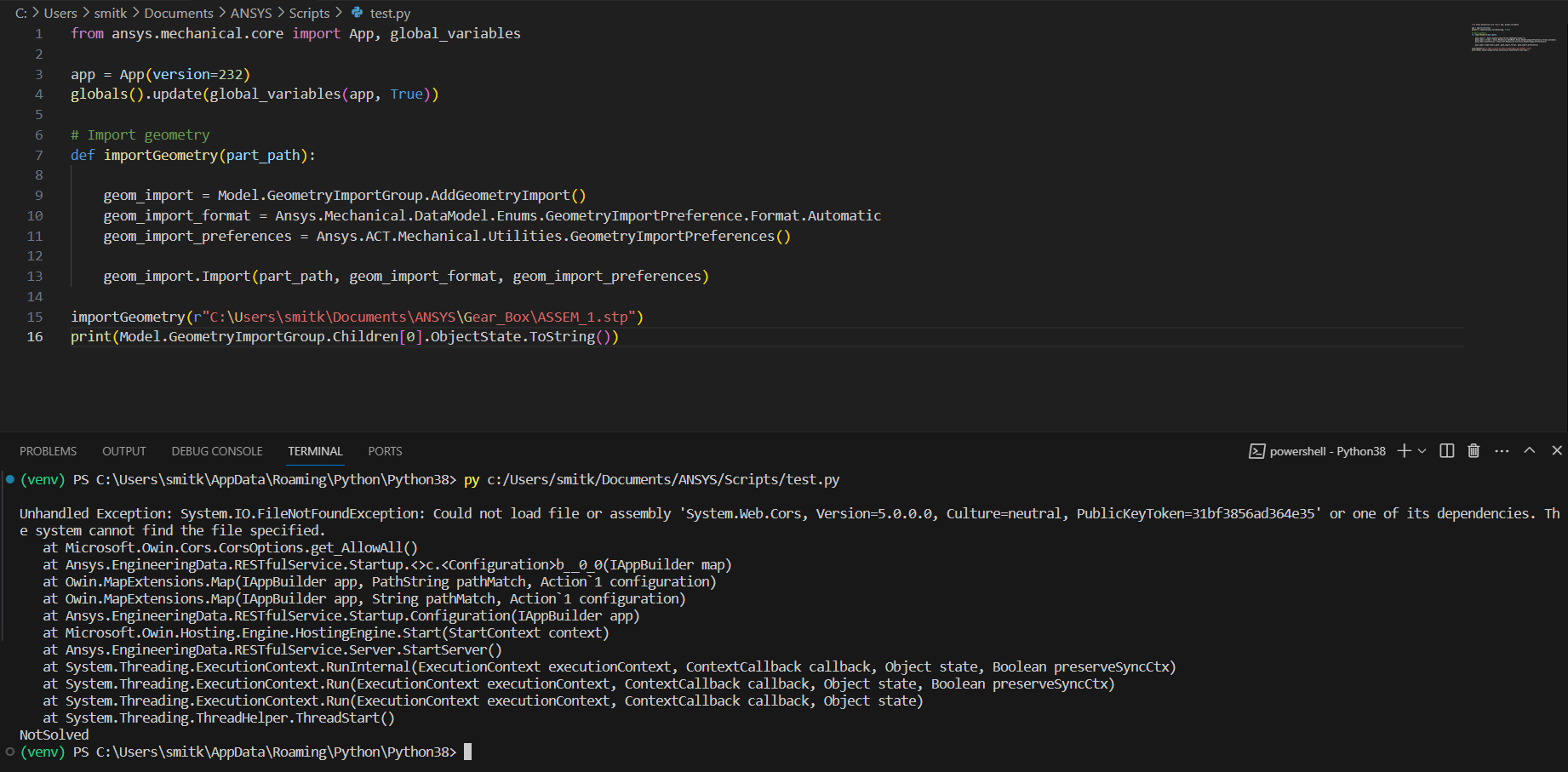

        Hello, I was trying to launch Mechanical 2022 R1 with PyMechanical, which is not supported, so I installed 2023 R1, and the previous error is resolved.
        However, I am having an issue with geometry import. I checked the geometry file path, it is correct and works when I run my code in Mechanical Scripting module. When I print the state of geometry import group, I get "NotSolved". Would anyone know why this happens?
        Following is the error I get, with an embedded instance of Mechanical in Python:-

      Hi
      Please install 2023 R2 and try this code (which works of course if all is set up ok):
      import os
      import smtplib
      import ansys.mechanical.core as mech
      work_dir = r'D:\PyAnsys\PyMechanical\demo'
      path_to_232 = r'C:\Program Files\ANSYS Inc\v232'
      app = mech.App(version=232) # starts a non-graphical Mechanical session within the python.exe
      globals().update(mech.global_variables(app)) # update global variables to get access to the same Model, DataModel, etc variables as in the Mechanical scripting consoleâ€
      # Add static analysis
      analysis = Model.AddStaticStructuralAnalysis()
      # Import geometry
      geometry_file = os.path.join(work_dir,'Valve.scdoc')
      geometry_import = Model.GeometryImportGroup.AddGeometryImport()
      geometry_import_format = Ansys.Mechanical.DataModel.Enums.GeometryImportPreference.Format.Automatic
      geometry_import_preferences = Ansys.ACT.Mechanical.Utilities.GeometryImportPreferences()
      geometry_import_preferences.ProcessNamedSelections = True
      geometry_import.Import(geometry_file, geometry_import_format, geometry_import_preferences)
