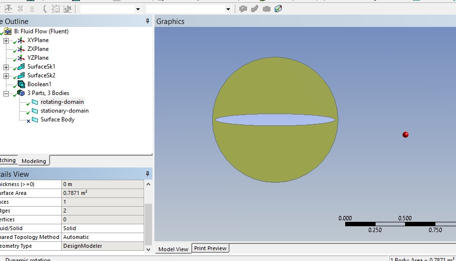

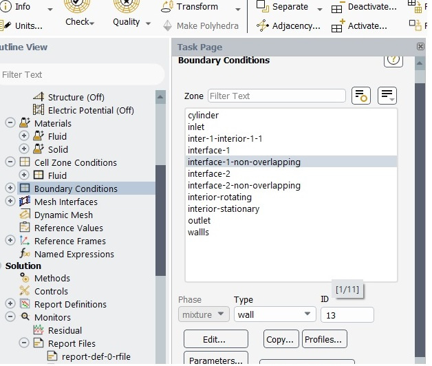

SubscriberI'm trying to simulate flow past a rotating elliptic cylinder using sliding-mesh. There is a "rotating-domain" and a "stationary domain". The mesh interface between them has been defined. Although, in the boundary conditions, it shows the interface as 'Wall'. I'm given to understand that there shouldn't be any interior walls between the two domains. So, how can I remove these interior walls?
Thank you.
November 12, 2020 at 10:42 amRob
Forum ModeratorPlease can you post an image of the geometry? Remember that the fluid cells also have an interior condition that represents the cell surfaces (edge in 2d & facet in 3d) so you might be looking at those. nNovember 12, 2020 at 2:34 pmpgvsec
SubscriberPlease can you post an image of the geometry? Remember that the fluid cells also have an interior condition that represents the cell surfaces (edge in 2d & facet in 3d) so you might be looking at those./forum/discussion/comment/97092#Comment_97092

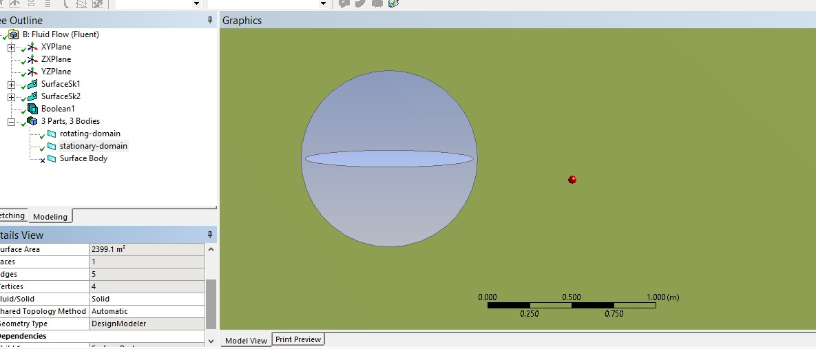

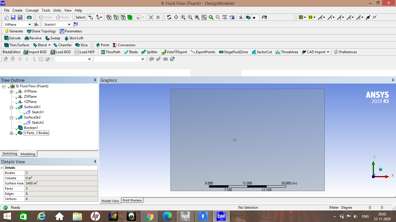

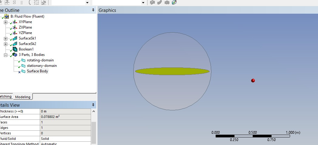

Hello Rob. Thank you for responding.nUsing the 'Add frozen' and 'boolean' operation, I've made three separate bodies - 1) Rotating domainn 2) Stationary domain n 3) elliptical cylindern
nn
November 12, 2020 at 3:53 pmRob
Forum ModeratorIf you're retaining the solid part into the Fluent model set it to be in the same part as the rotating zone. Otherwise that looks fine. nViewing 3 reply threads- The topic ‘Having problem with defining the interface.’ is closed to new replies.
