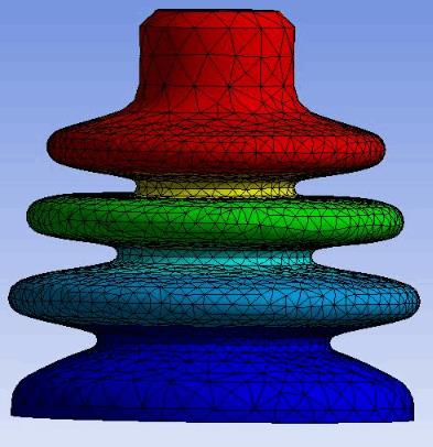

I am trying to simulate a rubber bellow using the VMQ silicone hyperelastic material. The bellow is deformed in the x-direction by 16 mm. I am trying to solve this problem in the static structural using the implicit solver. However no matter what I do, I always run into convergence problems after passing approx. 8 mm travel in x-direction. I also activated the Nonlinear Adaptive Region with 10 loops and removed the cyclic symmetrie, which I had before. Since activating the Nonlinear Adaptive Region I get the following Error:
The result cannot be evaluated because it has (1) an invalid scoping on a body with a changing mesh or (2) an invalid scoping when the result file is the mesh source. Body scoping is required for the result.
I know, explicit dynamics with this kind of large nonlinearity is the way to go, but as I am simulation multiple geometry variants, the explicit solver will be too time-consuming. Can you guys please help me out?

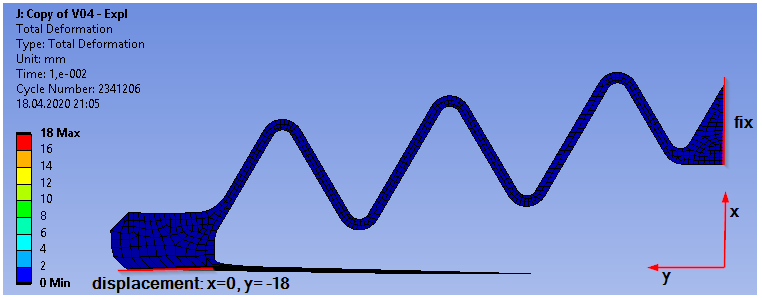

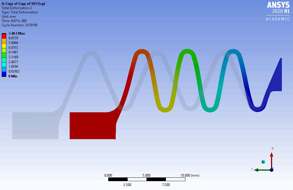

so as you suggested I ran this simulation in Explicit Dynamics, but unfortunately the force over travel plot is not representative any more as the kinetic effects are to dominent now. The solver output of this run showed a time increment of 4.096E-09s.
" alt="" width="449" height="263">
In a second run I used the Quasi-Static preset and entered the mentioned time increment for the Minimum CFL Time step. The damping cofficent was set to 0.1. This resulted in this:
April 18, 2020 at 9:09 pm
peteroznewman
SubscriberI suggest moving the load application point from the ID edge to the flat face of the top of the bellows (which is the left edge in the image above).
What did you use for a Boundary Condition? Please show a screen snapshot. Did you do a Step Change in Displacement of 16 mm and ran the simulation for 0.01 s? You need to ramp the displacement up from 0 to 16 mm over a long time, like 1 second. Note that ramping displacement causes a step change in velocity which creates some transients in the structure.
A smoother way to create the motion is to ramp the velocity of that top edge from zero up to some value at 0.5 s and then hold the velocity constant until time 1 s. Choose the velocity that results in 16 mm of displacement at 1 second. This motion and some damping in the material will greatly reduce the contribution of transients to the deformed shape in the structure at time 1 s.
