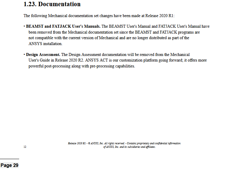

SubscriberI can't find the design assessment tool anymore. Has it been removed or renamed from 2022R1? I'm trying to follow this video from CAE Associates Inc. (https://www.youtube.com/watch?v=YXkI5rRBPqU). It's an older video but I have seen this done as of 2019.
April 21, 2022 at 1:17 amDecember 31, 2022 at 12:06 pmbhagwantP
Ansys EmployeeViewing 2 reply threads- The topic ‘Has Design Assessment Tool been removed?’ is closed to new replies.
