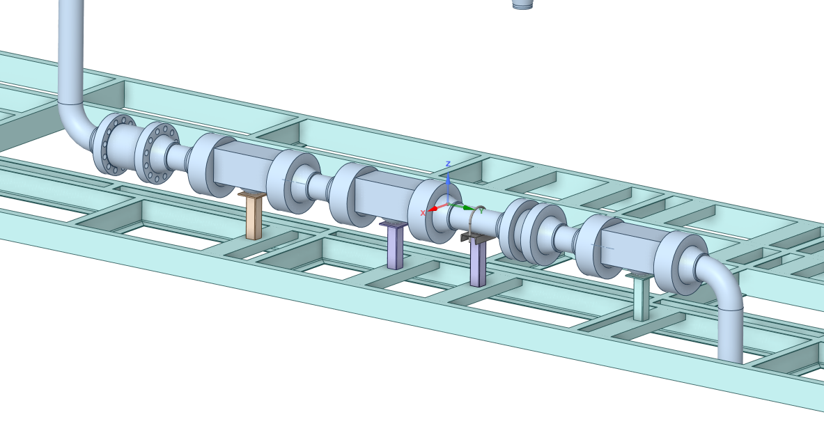

        The pump will stand on an independent concrete foundation slab. Pipes will go from the pump, which will stand on the structure as in the picture that I sent. I will apply 60 microns only to the pipes where they attach to the pump. Should I apply 60 microns in 3 XYZ planes? 60 microns per plane?
        I will analyze the pipes and whether they transmit vibration to the metal frame of the base
      Yes, you should apply the 60 microns to the flange of the pipe in three separate analyses: X, Y and Z axis.

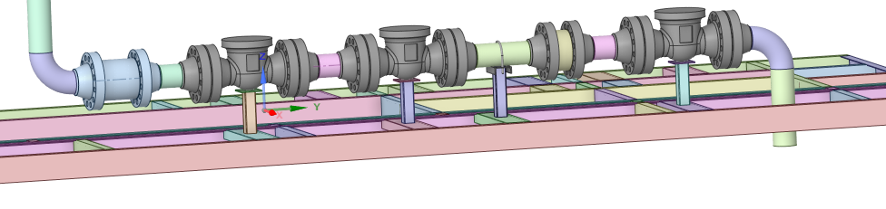

        1. The geometry of the pipe and metal base is very complex. I had to greatly simplify the geometry of the pipe, remove the holes on the flanges, simplify the valves, remove fasteners and chamfers and fillets on them. I made the pipe a single body in the space claim. I set the mass of the sliders through point mass in order to save the masses after changing the geometry. Is this allowed? Will this affect the accuracy of the calculation? Th frequency modes will not change much.
        It was like this
        it became so
        2.  How else can you forgive geometry? I ended up with 500,000 grid items. I have a powerful PC, 8 cores, 32 GB of RAM, but this is not enough, a memory error appears. I tried virtual topology, it didn't help either.

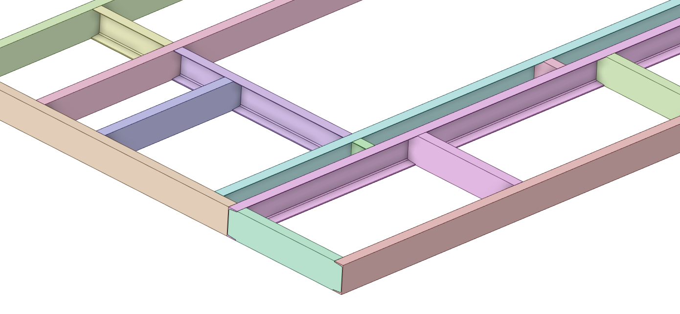

      The structure the pipes sit on looks like it is made from steel beams of various cross-sections. In SpaceClaim, use the Midsurface button on the Prepare tab to replace the solid model of the structure with a surface model.
      It looks like there are still some bolt heads on the flanges. Get rid of those.
      You must end up with the same mass in the idealized geometry as you have in the original geometry. You can do that by adjusting the density of the material to make up the missing mass.
      What is in the pipe, is it a gas or a liquid?  If it is a liquid, you need to include the mass of the liquid.

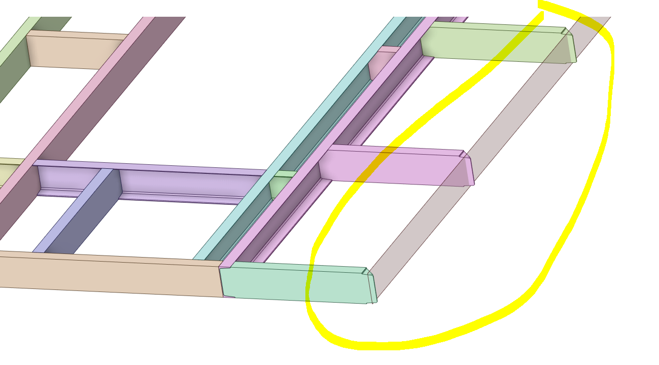

        I would like to make a base using surfaces. But the foundation consists of a channel. When you extract the surface, you get just a sheet. This is right?
        The pipelines also have a pressure of 10 MPa, should it also be set?
      Does the C-channel section have a uniform wall thickness, or are the short side ribs tapered?
      Midsurface only works on parallel faces, so you can't capture tapered ribs. You can convert the channel to a Beam model, which will replace the solid body with a beam with the correct cross-sectional area properties.  Beam elements are a higher level of idealization than Shell elements.  If you want to use Shell elements, you won't use the Midsurface button, you will pick the three outside faces of the C-channel and do a Ctrl-C, Ctrl-V to create the surfaces to mesh.  You will manually assign a thickness to those surfaces in Mechanical. The tapered ribs will be assign a constant wall thickness, like the average between the base and the tip of the rib.

        I also thought about extracting the profile of the metal base into the beams. If the base is in the form of beams and the pipes are solids, will this be ok? Unfortunately, the profile has a flat only vertical wall, the horizontal walls are upper and lower with a bevel.

      Yes, you can have a beam model for the supporting structure.

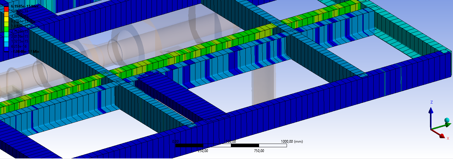

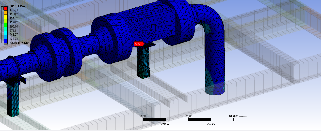

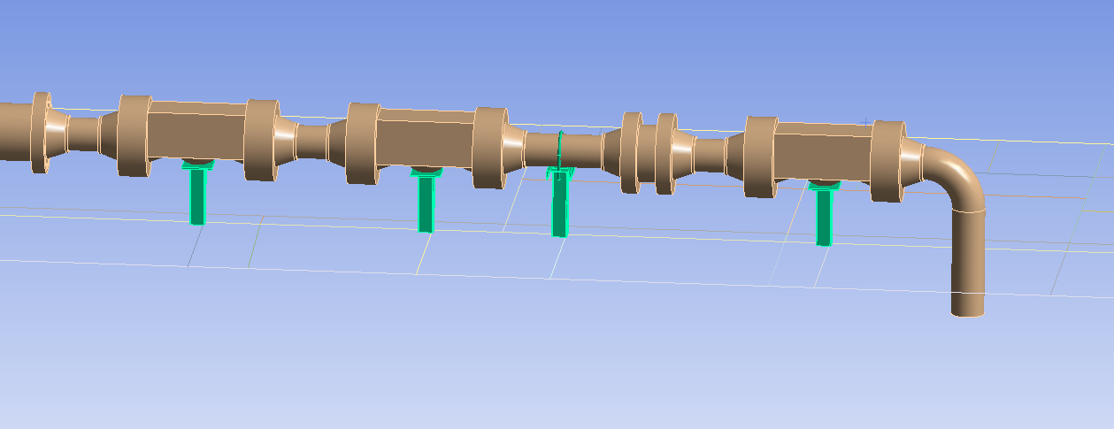

        I made a metal base on which the pipe stands with beams. When the pipe is deformed, loads are not transferred to the base from the beams.
        Pipe:
        Beams:
        Why?

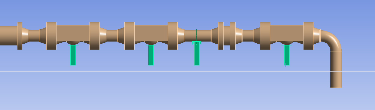

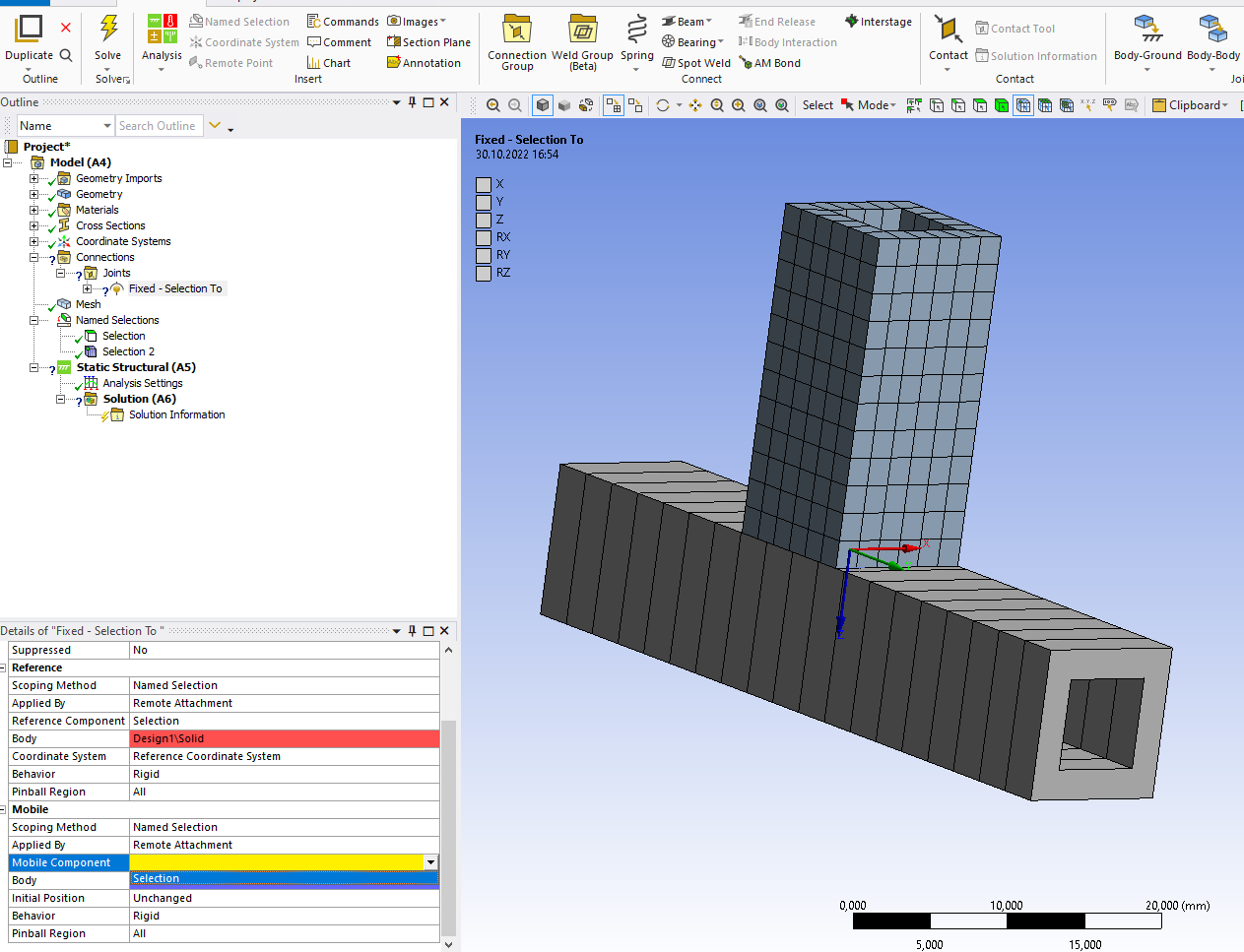

      Please show the Fixed Joint that goes from the bottom of the solid vertical stand to a set of nodes on the beams.
      • javat33489
        ok, connections:
      You have scoped it to the entire Edge. It would be better to scope it to the nearest single Node on the line body.

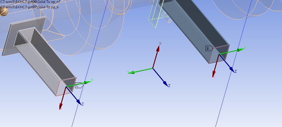

        Sir, this is not working in workbench. No nodes can be connected to a line or surface either in contact or in a joint(
      Pick a Node and make a Named Selection. A joint can use a Named Selection.
      • javat33489
        Sir, this is not working in workbench. Named selection (with nodes) cannot be selected:
    • javat33489
      Change Applied By from Remote Attachment to Direct Attachment
      • javat33489
        Thanks it works. This only works for one node.
