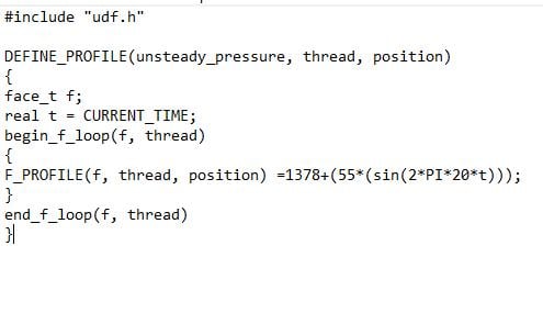

1) My problem is to solve the vibrations in the compressor piping system. In this regard, the pressure at the outlet of the compressor is in pulsating nature (Transient Analysis).This is because the compressor is a reciprocating machine and it produces pulsating pressure.The pressure pulsation can be seen in the image shown below,
The applied load is defined as y=1378+(55*(sin(2*PI*20*t))). For this pulsating pressure Boundary Condition I have used a UDF as shown in below figure
Here it can be noted that the applied frequency has the frequcncy of 20 Hz, because the compressor running speed is 1200 rpm.

SubscriberThe period of the pulsating pressure is 50 ms. When you simulate with a 10 ms time step, you are putting just 5 points on a single cycle of a sinusoidal curve. That is a very poor representation of the curve. The recommendation is a minimum of 20 points per cycle, therefore you would have a time step of 2.5 ms.
How are you initializing the simulation? You could run a Steady State simulation and converge on a flow at the average pressure of 1380 kPa. Are you doing this? Then from this steady state flow, begin the Transient simulation and introduce the pulsations. How many seconds are you simulating? If your end time in the Transient is 2.5 seconds, that is 1000 time steps.Â
The oscillating pressure goes from peak to valley in 25 ms therefore, the forces on the walls are going to be different at the maximum pressure compared with the minimum pressure. Make a plot at two different times, one when the pressure is maximum and another plot when the pressure is minimum.
