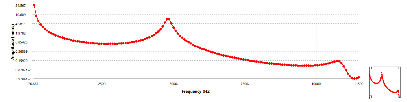

      Hi, i am trying to determine the frequency response in the Y- direction for three surfaces/points.
      1 at the contact between the two small accelerometers (left and right), and the top of this 'dual rail magnet', where another accelerometer sits (point mass A).
      this setup is trying to replicate what I have in a lab, where a vibration exciter is exciting the bottom of the 'rod' in the global Y-axis.
      It manages to read some resonance points for some mode shapes, but there are other mode shapes (such as 'total deformation 8') that the harmonic analysis frequency repsonse does not pick up.
      The two small accelerometers would be experiencing signifcant resonance at this 8th natural frequency, as would the acceleromter mounted upon the large dual rail magnet, but this is not reflected at all in the hamonic response frequency plot.
      it is my belief that there should be a y-axis resonance here, but it appears not.
      i tried selecting different geometry, such as a node on the edge of the dual rail magnet cylinder, and set some to use "maximum" instead of average but no luck. in the simulation inside the modal analysis, i can see that the node i selected in moving in the Y- direction, as well as moving side to side in the x direction...

      You were expecting to see a resonance of Mode 8 in the Harmonic Response. Not all modes resonate in the Harmonic Response. Consider a cantilever beam. The first few modes are bending around the low thickness direction, then there is a twisting mode, and later there will be a bending mode around the high thickness direction. If the harmonic load is only normal to the thin direction of the beam, then you will only see the first few bending modes show up. You won't see the twisting mode because there was no load to excite that.  If you use two harmonic loads, one on each corner of the tip and they were 180 degrees out of phase, that would excite the twisting mode.  In your model, the geometry is symmetric and the load is centered and aligned to the Y axis, so there is nothing to excite Mode 8.

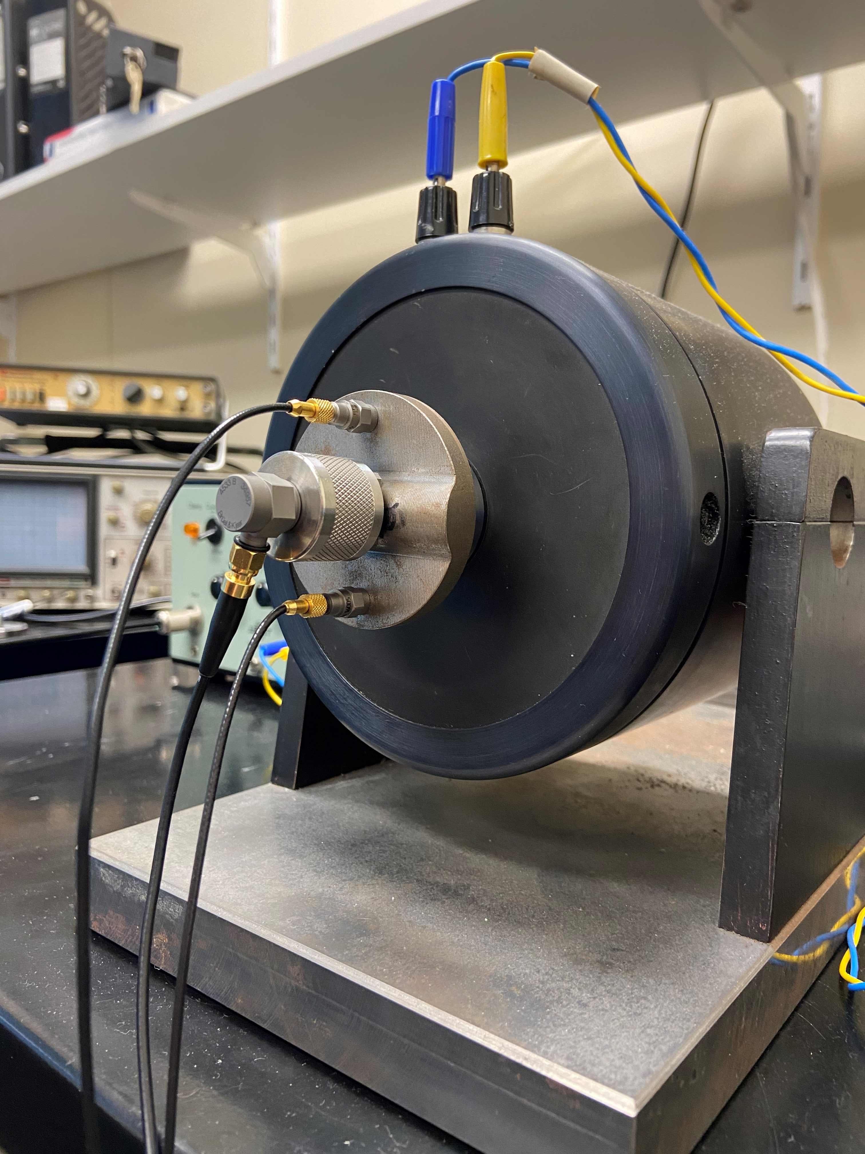

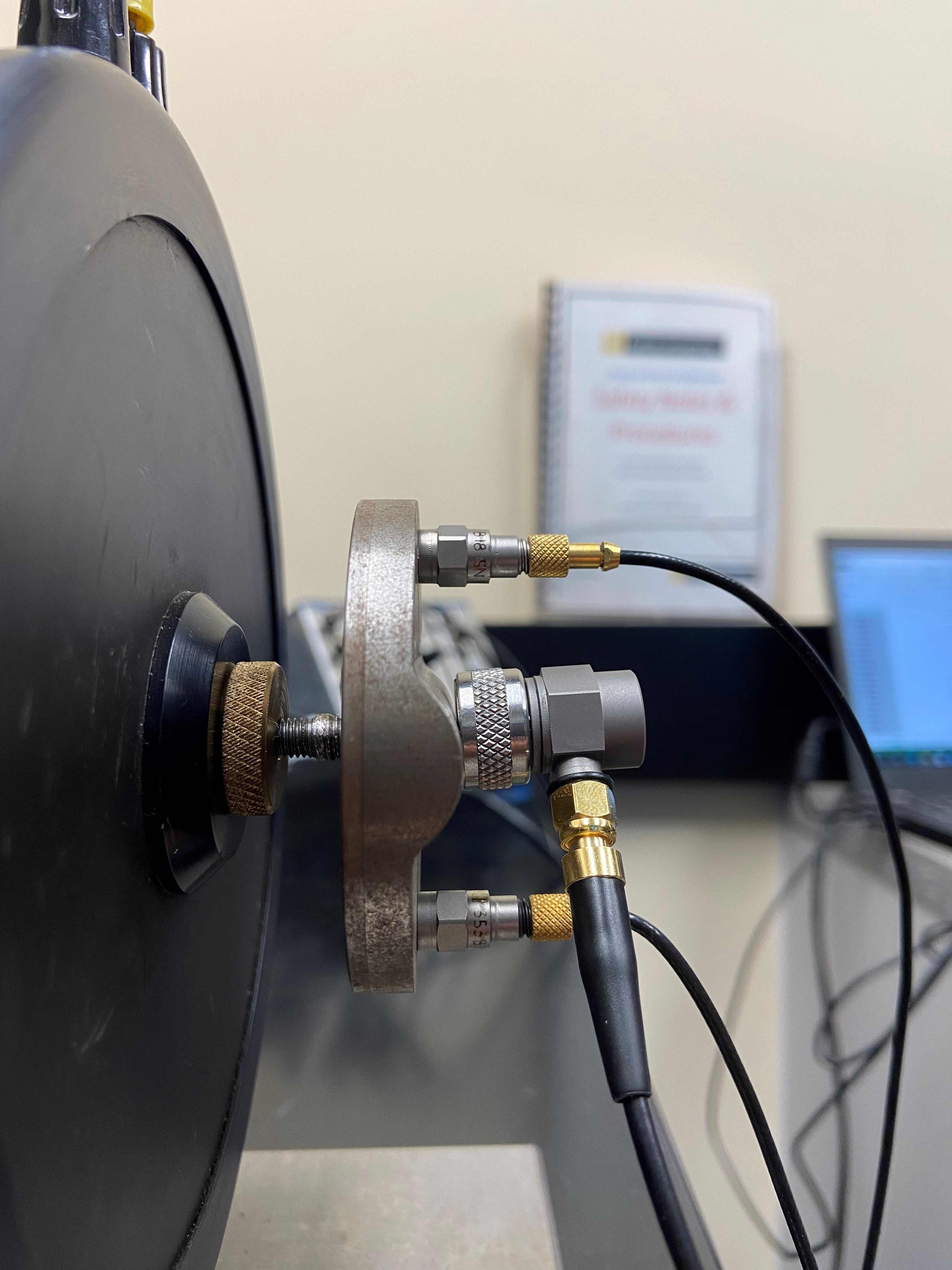

      1 - the test-specimen is affixed to the moving part of the vibration exciter via a double ended stud bolt (See photo 1), and I beleive that this connection is not stiff enough ie the first mode is lower than the highest mode of interest. I beleive the setup is flawed, but i just need to be able to model it as best i can with FEA, i will address the concerns in the discussion of my thesis.

      3 - i dont know much about exciter tables. the vibration exciter sits on a heavy steel plank which rests on a table. photo 2 shows this.

      Thank you for the photos, that really helps to explain what you are trying to model. I agree that the single stud is going to create a cantilever beam support to your test specimen.
      It is often the case in simulation where perfect geometry and perfectly aligned loads don't create a result that matches an experimental result. An example is a column under a compressive load in a nonlinear static structural analysis. The column just compresses, but experimentally, it buckles. In order to simulate reality, imperfection in the geometry is introduced and/or the load is applied off-center. You may need to introduce some small amount of imperfection to see Mode 8 appear in the harmonic response results.

      Wow, of course! I have shifted the centre of mass of the accelerometer off centre a little bit, which accounts for the non-zero effect of the wires attached to each accelerometer. It is now showing something in the region i expected, but of a lower magnitude than i thought. I will see what else I can do by playing with the geometry and shifting the point mass around... might not be large enough to have a significant impact.
