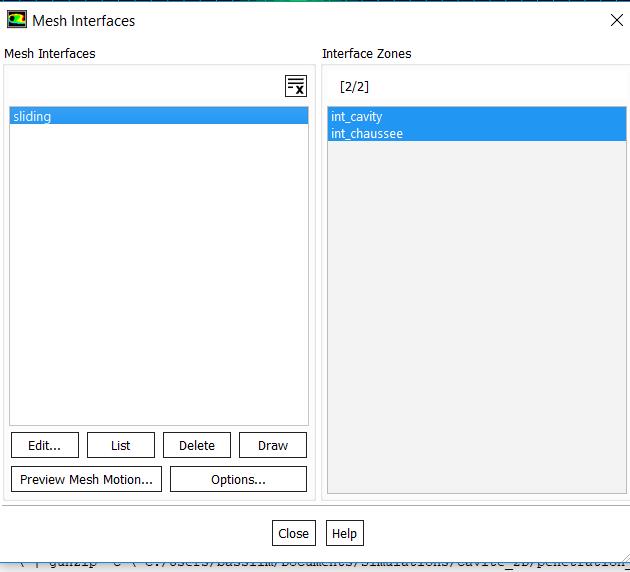

SubscriberHello! I have a sliding interface between two walls. So Fluent generates a wall boundary for each interface. Now, i want to apply a dynamic mesh for one of the two walls ( membrane deformation using a uDF grid motion). I was thinking to apply the wall as a deforming zone but i was surprised that the motion didn't work unless i define the interface as a deforming zone not the wall! and this is caused me problems in the motion because it caused the displacement of the other wall without even defining it as a deforming zone! Is it logic!

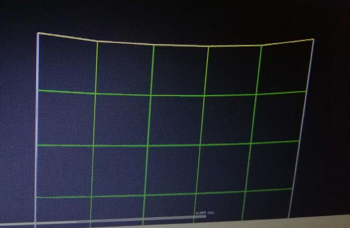

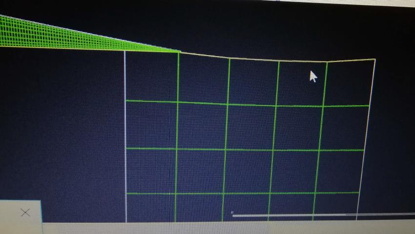

SubscriberI have a cavity moving in x direction on a road. The interface is between the road and the cavity. I considered the movement in x direction by putting V=10 m/s in the cell zone conditions of the cavity (fluid: air) . Now, for the movement of the top wall of the cavity, i considered the top wall of cavity as a dynamic mesh zone but the displacement failed. I considered the interface top of the cavity as a dynamic zone, i got a displacement for the top but also for the road!

Subscriberfor the grid motion, i have a table of points assigning at each time step, a displacement for each node of the top wall (does fluent also divide the interface into nodes like for the wall? because i am afraid that the nodes aren't well read by the udf if the deforming zone is an interface not a wall)
