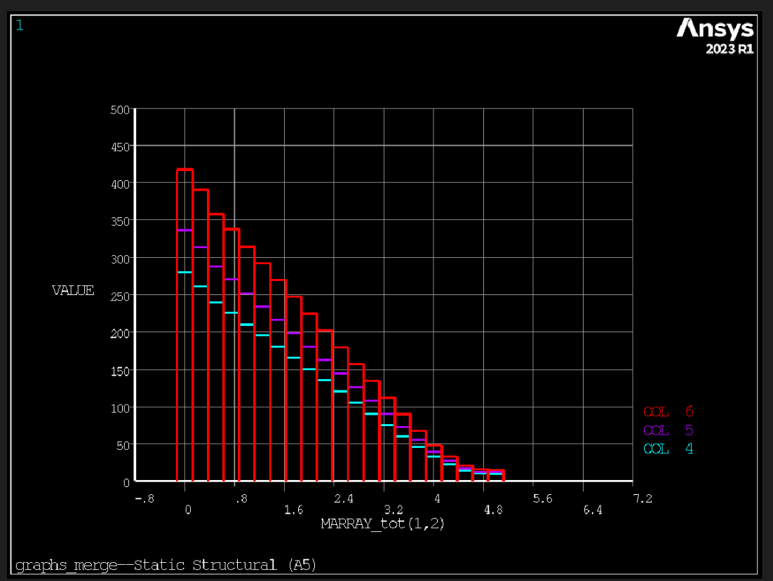

    • shravani.bojja
      Hello Erik,
      I tried to use below commands for generating the graphs at different design points, however the graph is shown consisting of histograms (as shown below). Could you please let me know which commands can be added to make it a line graph (as required).
      Commands:
      *VPLOT,Mvalue_tot(1,2),Mvalue_tot(1,4),5,6
      /SHOW,png
      /replot
      Resulted graph:

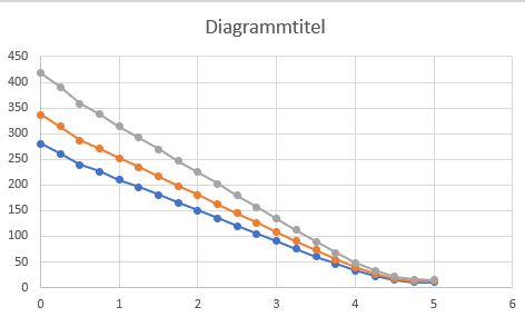

      Required graph (taken from excel file):
