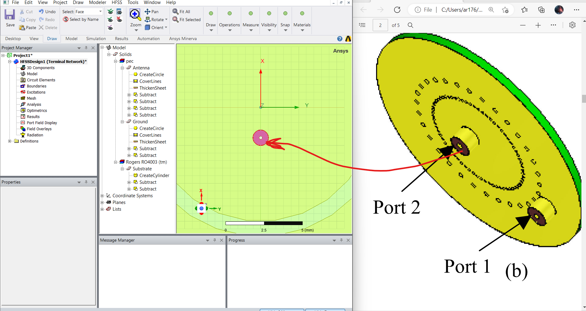

    • Abdur Rehman
      I want to add color only to a specific face of a cylinder, but cannot find "Graphics Toolbar" anywhere. I'm using Ansys Electronics Desktop 2022 R1.
      Please help. Thanks.
