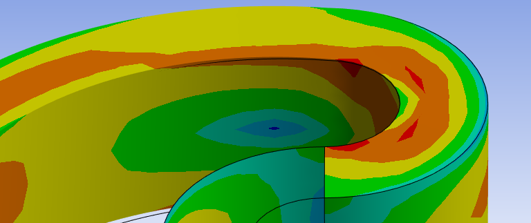

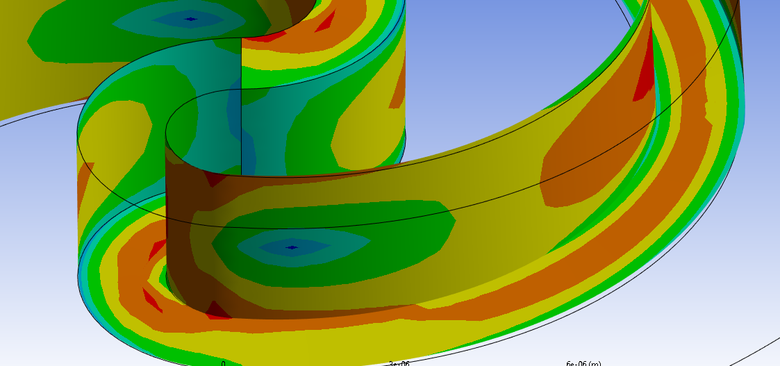

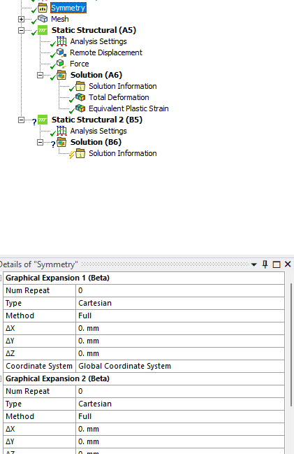

I am modelling bending of symmetrical spiral with Symmetry Expansion add-on (Static Structural module in Ansys Workbench). Unfortunately display of the symmetry is only presenting bottom and back wall of the structure
While the "original" part is displayed fully
I would appreciate any help on what might be causing this
Regards, Piotr

Ansys EmployeeHi Piotr Kucia,
Can you please confirm which Ansys version you are using? I hope you are using the below feature for symmetry expansion, or is there anything else which has been used?
Also, can you please share the snapshot of the actal CAD, top view will be helful. Please try to include the Axes triad as well so it will be used in our further communication.
Sourabh
