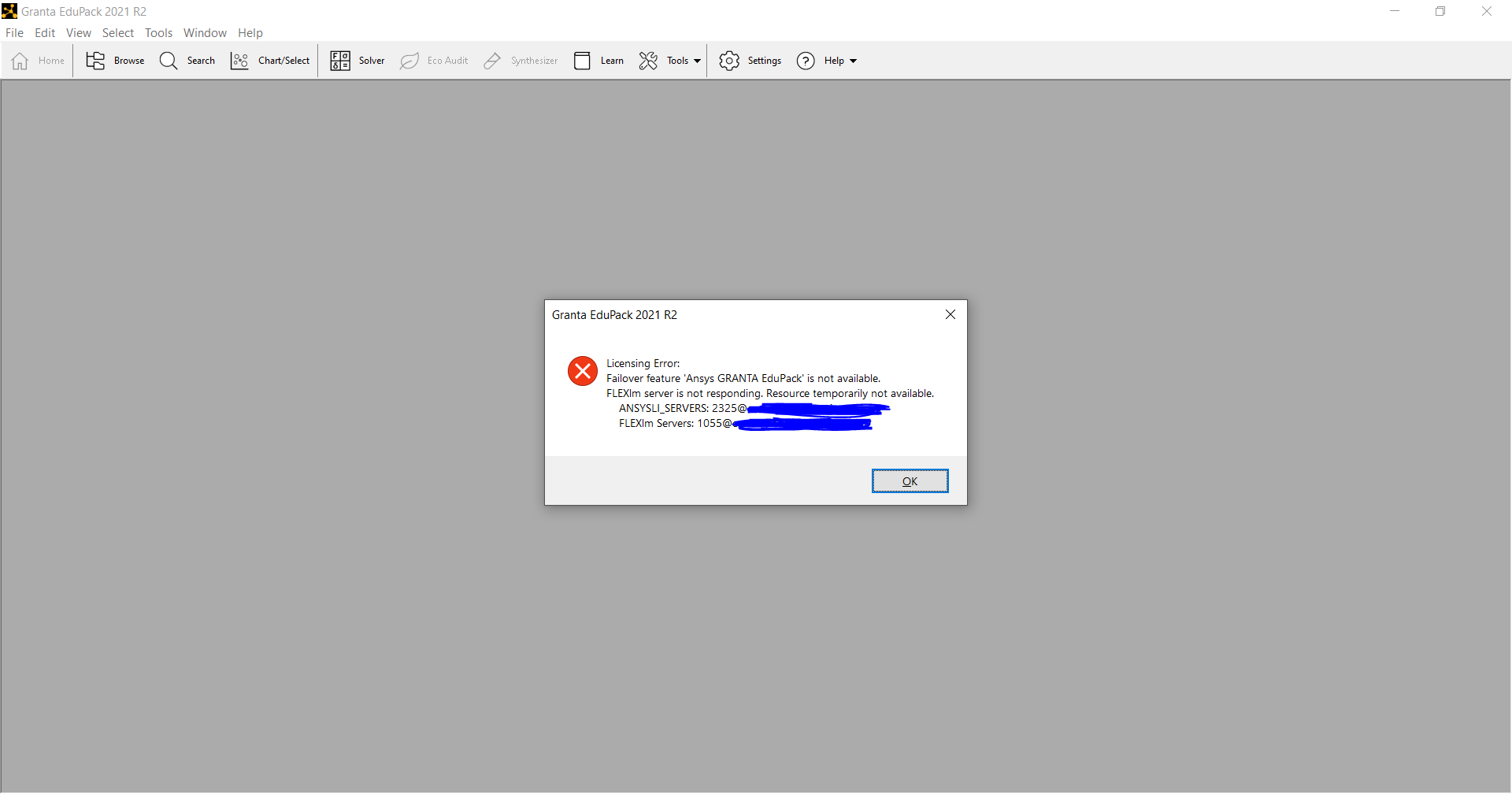

SubscriberHi there,
Since yesterday my Granta Edupack isn't working anymore. Due to an error that has something to do with the FLEXlm server I suppose?

What happens if you run Client Licensing Utilities and try to perform a Flexnet Publisher License Status?
March 8, 2022 at 4:49 pmSanne
SubscriberI disabled my firewall, it doesn't work.
If I peform a Flexnet Publisher License Status I get this:
1055@---------
lmutil - Copyright (c) 1989-2019 Flexera. All Rights Reserved.
Flexible License Manager status on Tue 3/8/2022 17:45
[Detecting lmgrd processes...]
License server status: 1055@wi690-sep
License file(s) on wi690-sep: 1055@--------
lmgrd is not running: License server machine is down or not responding. (-96,7:11001 "WinSock: Host not found (HOST_NOT_FOUND)")

Ansys EmployeeNeed to confirm with the school if cesedupack.license.schoolname.nl is an alias for wi690-sep.
The status indicates the server has wi690-sep in the license file. If you can't resolve that hostname
you should try the ip address or add a hosts file entry for the ip address and hostname.
You may need to work with School IT Department.
