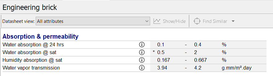

      You can find some information on porosity for certain material families for which this property is particularly important such as Foams and Honeycombs (please see the property relative density in material records for foams and honeycombs in Level 3 within the Hybrids folder). However, for these material families, the only information that we can somewhat relate to permeability is Water Absorption (Weight gain (%) after a sample of test material is immersed in distilled water at room temperature for a specified period).
      On the other hand, you can find the properties Permeability (02), and Water Vapor Transmission ( the volume of water vapor that will pass through a unit thickness of material per unit area per unit time per unit barometric pressure )in multiple materials in the Architecture database or in the Polymer material family in the core level 3 database.

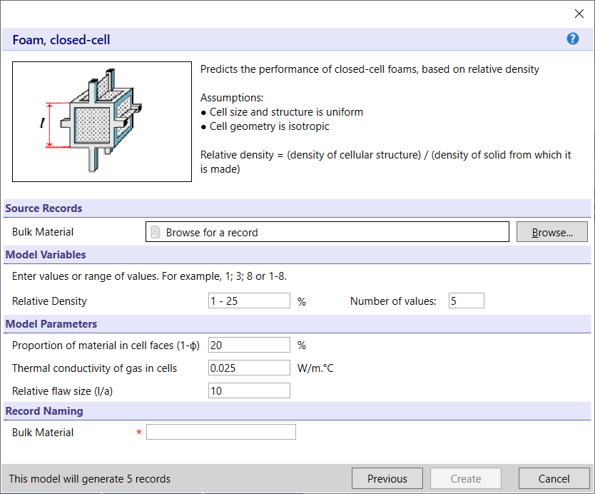

    • David Mercier
      Hi Nick In terms of porosity question, you can estimate some properties of architectured materials with porosity (relative density) as a parameter. Below a screenshot of the Synthesizer tool in EduPack (advanced levels only) that allows you to do such estimations. You can find more about Synthesizer in the discussion below. By the way, porosity is not really a material property, but more a microstructural parameter like the grain size in metals or the crosslinking rate in polymers...

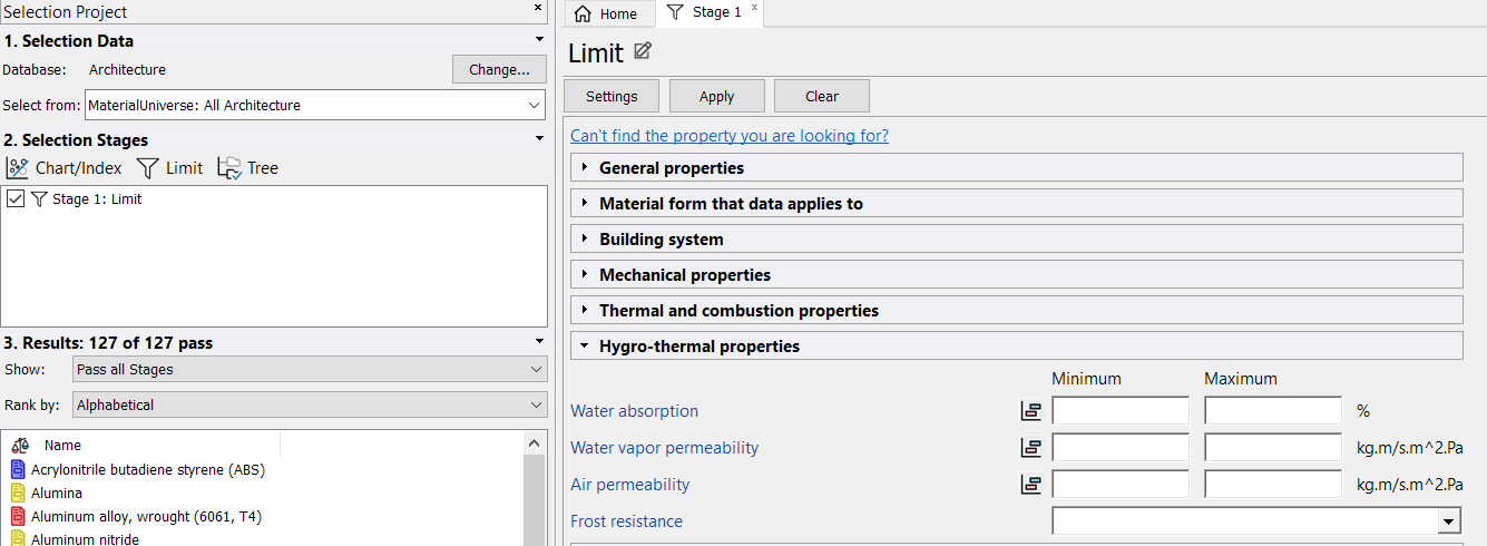

    • David Mercier
      Hi You can find such data for some materials (eg bricks), and set such properties as a limit in the Architecture database. But I don't think there is anything about the quality or the type of water (rain, muddy or sewage...).
