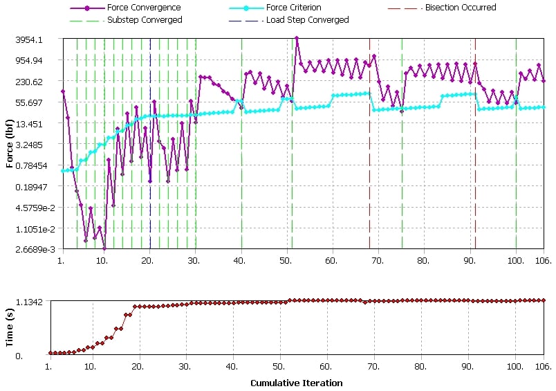

SubscriberAttached is a model that has two steps. In step 1 gravity settles the wheels on the rail. That step converges. In step 2, the pressure on the pin is applied. I interrupted the solution because the progress was slow. Some improvements to the mesh should help that to converge faster and/or get to the full load.

unfortunately in my pc I can't start the simulation due to the lack of physical memory (I attach the error). I tried to resize the model but for now I can't finish the simulation. I kindly wanted to ask you if, in your opinion, is it possible to resize the model for my pc (maybe with the mesh, losing some information far from the contact area or changing the analysis settings) or should I start it in a more powerful pc? In the latter case, would it be possible to know first if the model works (i.e. to find the most stressed external wheels) ?. Looking forward to your reply, I greet you and thank you again.

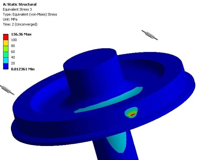

SubscriberHere is the stress on the highly stressed wheel with 12% of the pressure load applied.
It looks like you should lengthen the rail as it has a significant stress from the lateral load.
The model used 65 GB of RAM to run on 15 cores. Below is the estimate of what it needed to solve on the Direct solver.
DISTRIBUTED SPARSE MATRIX DIRECT SOLVER.
 Number of equations =    2741893,   Maximum wavefront =   486
 Local memory allocated for solver             =  1860.268 MB
 Local memory required for in-core solution    =  1503.372 MB
 Local memory required for out-of-core solution =   511.975 MB
 Total memory allocated for solver             = 35643.631 MB
 Total memory required for in-core solution    = 28801.184 MB
 Total memory required for out-of-core solution =  9127.276 MB
If you can upgrade your RAM to at least 16 GB instead of the 8 GB you have now, it could solve out-of-core. If you can afford it, install the maximum RAM your motherboard supports. Â
This model could be cut in half and use symmetry through the center of the pin. That would reduce the memory requirements.
