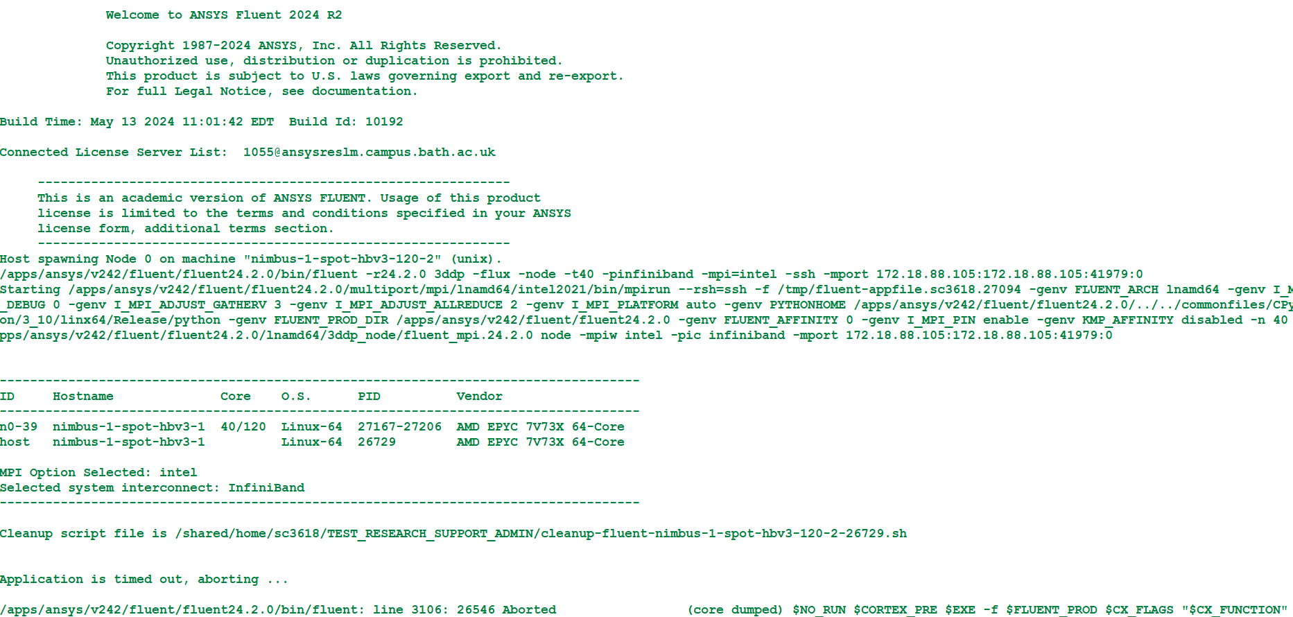

      Hi there,
      I keep getting this error
      >  /solve/dual-time-iterate 1e-2
      ERROR: Invalid integer or integer not within limits [0 to #f].
      Error object: 0.01
      [Hit ENTER key to proceed...]
      300
      Maximum Number of iterations per time step [10]
      ERROR: chip-exec: function "none" not found.
      Anything I can do to debug this?
      Details:
      Ansys v222 and v242
      Operating System Linux Almalinux
      Intel or OpenMPI
      Roberto Scipioni
      Red oak Consulting UK

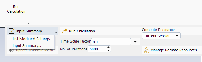

      The problem you’ve posted above is actually the journal isn’t correct, the argument following /solve/dual-time-iterate is an integer number of time steps, and not the time step size. Your users should be providing valid journal scripts, although I’d tend to set everything via the GUI and the batch script should just load case & data, run the job, write case & data and close.

      So I tested it using:
      fluent 3ddp -t120  -gu -driver null -cnf=$HOSTS -pinfiniband -cflush -i  inputFile.in
      in the output we get:
      >  /solve/dual-time-iterate 1 300
      How do I run
      interactively?
      Many thanks
      Kind regards
      Roberto
    • roberto.scipioni
      Ok got the interactive session :-)

      I assume you've got inifiband mpi? If you've got an interactive session, what did you set in parallel, and was there anything useful in the transcript (.trn file).
      The chip exec means Fluent's looking for something UDF related "somewhere".
      On launch I see this for interconnect
      MPI Option Selected: intel
      Selected system interconnect: default
      You might need someone who can use Fluent to troubleshoot the Fluent part. Under Solution tab, and possibly under Run Calculation (my screen resolution isn't good) look for "List Modified Settings". That should tell you everything that's been changed. You're looking for a UDF (libudf) or a blank line.

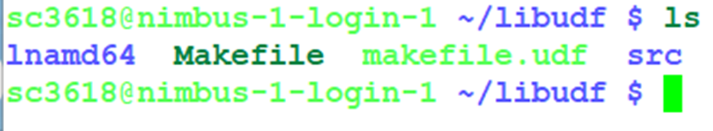

      Is libudf part of the Ansys/fluent software or is it a separate thing?
      this is what I found in the user space. Does it need to be compiled?
      Should not this be included in the standard fluent directory?
      Please advice
      Kind regards
      Roberto
      The libudf folder is created by compiling a suitable .c file so that Fluent can work with the library. It's read by Fluent as part of the model set up.
    • roberto.scipioni
      Something like this?
      R.
      Yes. You'll need to compile some or all of the .c files. I'm fairly sure they can all be compiled at once into the one libudf, but you also need to check with the user as to what they set up.

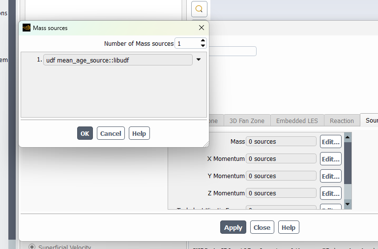

      How does fluent know that he "needs" to use these udfs?
      A tag at the command line or?
      They're added into the case file, in this case a cell zone effect. When I write & later read this case it'll look for the libudf and on finding it be happy.
      If that libudf isn't present you may get a chip exec error, or something else more terminal depending on what the UDF is for.

      It doesn't. The /solve/dual-time-iterate command triggers the Fluent solver to execute some iterations using the settings in the case file. That case file does know about the UDF along with the mesh, boundary settings etc.

      Hi, I am Sylvia the user that got the original error. I need to figure out how to use the libudf with fluent. Can you please help me?
      OK. Have you got the .c file?  If so, it needs to be compiled for the OS and parallel for the cluster AND the libudf needs to be in the working directory on the cluster.
    • sc3618
      Hi Rob, I have recently started working with it but sure what it means. Could you please provide me some sample files ?
