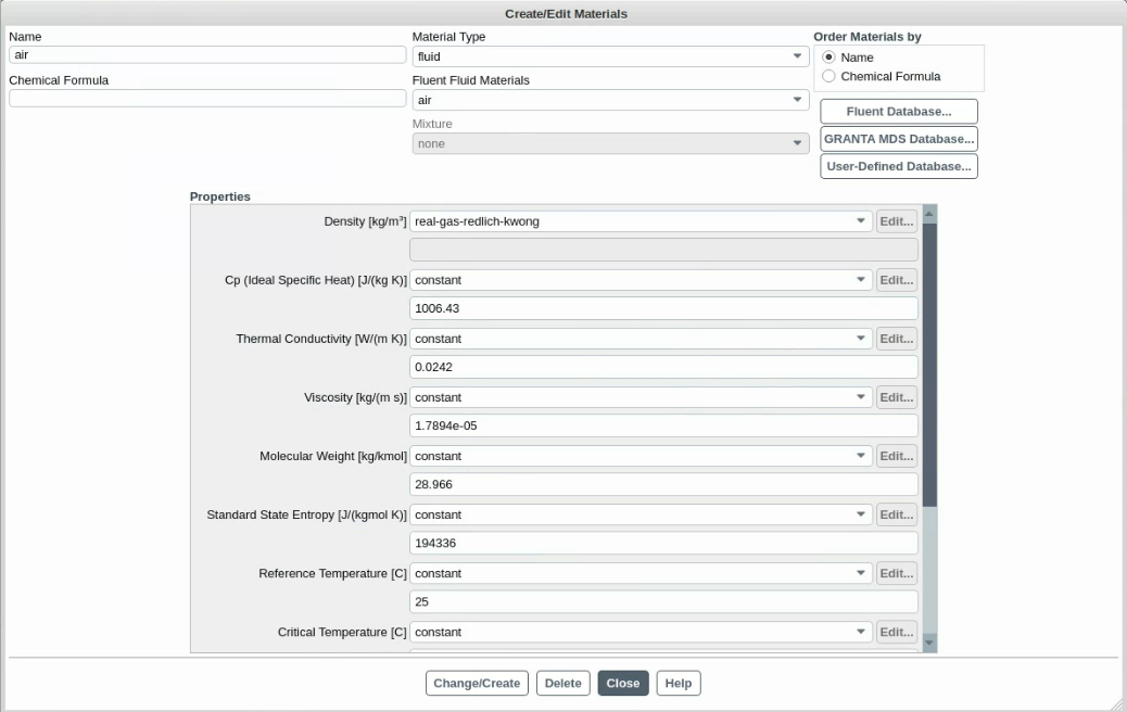

January 30, 2023 at 7:59 pm
reza121
SubscriberThanks for your reply Rob,
You are right. activating the operating density sounds like a better solution for that. I am using the "real gas redlich-kwong" material model for my airflow and I get the following warning when I changed my operating density to 1.1845 kg/m^3:
Warning: For compressible (ideal and real) gas models with buoyancy,
 it is recommended that you use a specified operating density value of zero:Should I ignore it or will it cause any problems you think?
January 31, 2023 at 11:18 am
Rob
Forum ModeratorI'm not sure you need a real gas model. I've generally ignored that warning as it tends to be aimed more at supersonic flow & the like. I also tend to avoid compressible flow of that type as it's outside my area of expertise. How do the results look?Â
