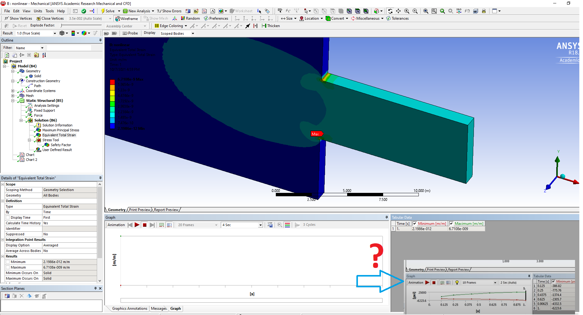

How can I get the change of strain in terms of time in my graph similar the one shown by the arrow in the lower right hand side of the photo. I only get max and min values in the graph.
The force is applied in 1 step in both my model and the one shows a curve.

You probably need to have some sub steps I suppose so you have more than one result step to show - so try changing substeps to 10 in the analysis settings and step control.
See this discussion about sub steps:
You donÔÇÖt wanna step to this: Breaking down Loadsteps and Substeps in ANSYS Mechanical ÔÇô PADT, Inc. ÔÇô The Blog (padtinc.com)
