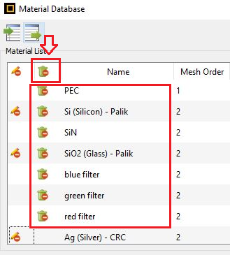

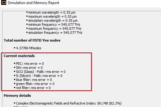

Ansys EmployeeHi Andy Thanks for your question. Are you referring to materials listed under ÔÇ£Current materialsÔÇØ:
Alternatively, you can use the GUI to find these materials through the database. To do this click on the delete icon on the top. This would place the materials that can not be deleted on the top (since they are in use):

SubscriberHi Khash Yes, option 1 you show for materials listed under "current materials". I need a script command that will give me that list of materials names. IS that possible?

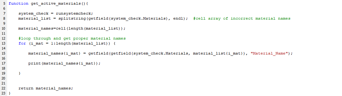

SubscriberHi Khash It's a bit convoluted, but now that I see everything is built on struct data I can use nested getfield() functions and get the proper Material_Name without having to handle the incorrectly formatted Materials.
Combining trobert's code with yours, I can get the proper names of all active materials with the function I created below.
