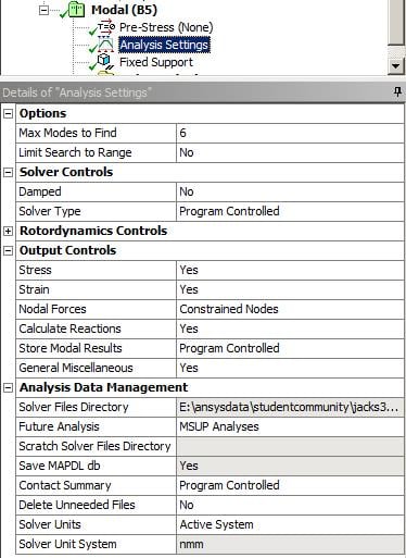

      On a Modal Analysis, I changed a few items so that files were not deleted after the solution was completed.
      I don't know if it was Future Analysis or Delete Unneeded Files or another setting that was useful.
      Reading the solver output, I noticed these lines...
       DO NOT COMBINE ELEMENT SAVE DATA FILES (.esav) AFTER DISTRIBUTED PARALLEL SOLUTION
       DO NOT COMBINE ELEMENT MATRIX FILES (.emat) AFTER DISTRIBUTED PARALLEL SOLUTION
       DO NOT COMBINE ASSEMBLED MATRIX FILES (.full) AFTER DISTRIBUTED PARALLEL SOLUTION
       FORCE WRITING OF THE EMAT FILE
      I expect you want to find the APDL command to combine those files rather than to have them remain split.  I turned off Distributed Parallel and solved a small problem on one core as a workaround.  Here are the list of files in the MECH folder after the solution.
