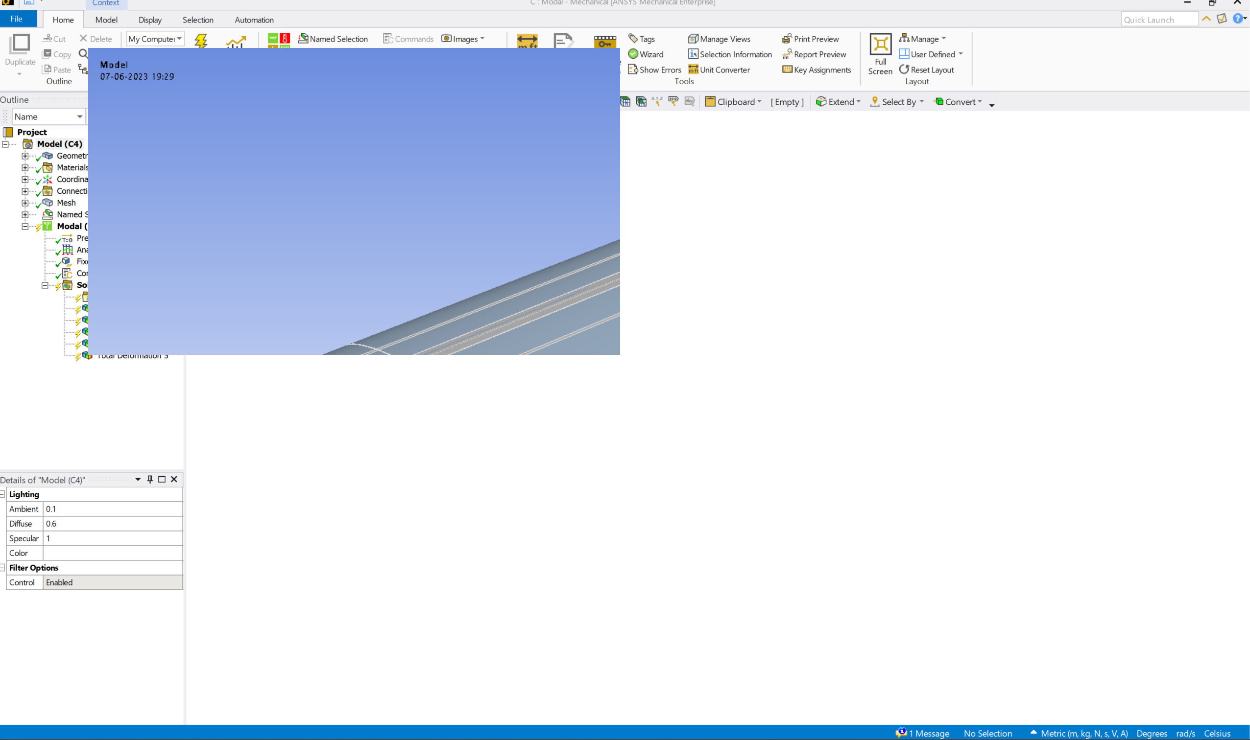

      My problem is that the geometry window of the mechanical is stuck. I cannot reset the window or move the window. It's just stuck. A screenshot of my mechanical window is shown below. How to resolve this issue?

      Hello Anirudh,
      This might be something related to your graphics card, did you make any changes in your graphics setting? Try upgrading all your graphic drivers. If the issue persists, you might need to reset app data.
      To do a APPDATA reset:
      a. Completely close out ANSYS (any and all open projects)
      b. Open a Windows Explorer window and in the bar at the top input: %APPDATA%
      c. Go into the Ansys folder, let's say you have version 23R1
      d. Rename the v231 folder to v231_old (so that there isn't a folder named v231)
      e. Launch ANSYS and all your setting will be reset.
      Things like Windows updates, system crashes, hard shutdowns, etc., can impact your settings, so cleaning them out on occasion is a good thing.
      If resetting app data didn't help, you might need to check for your DPI settings, are they default or changed to "system" or "system enhanced"?
      You can right click on Ansys Workbench then open file location. right click again of Ansys workbench and go down to properties.
      1. Click on compatibility then go to Change high DPI settings.
      2. Check program DPI, check the override scaling too and change it to System Enhanced.
      3. You also better use the DPI to be displayed when you use the program.
      4. You should then restart your pc.

    • Anirudh Thantry
      The AppData reset didn't work but changing the DPI settings worked.
