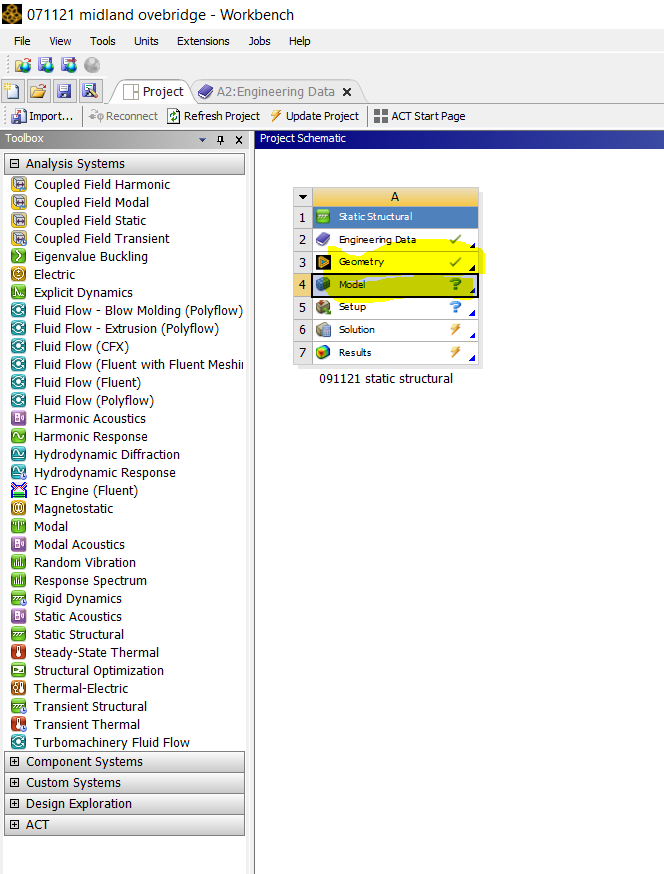

    • Sia
      Hi everyone,

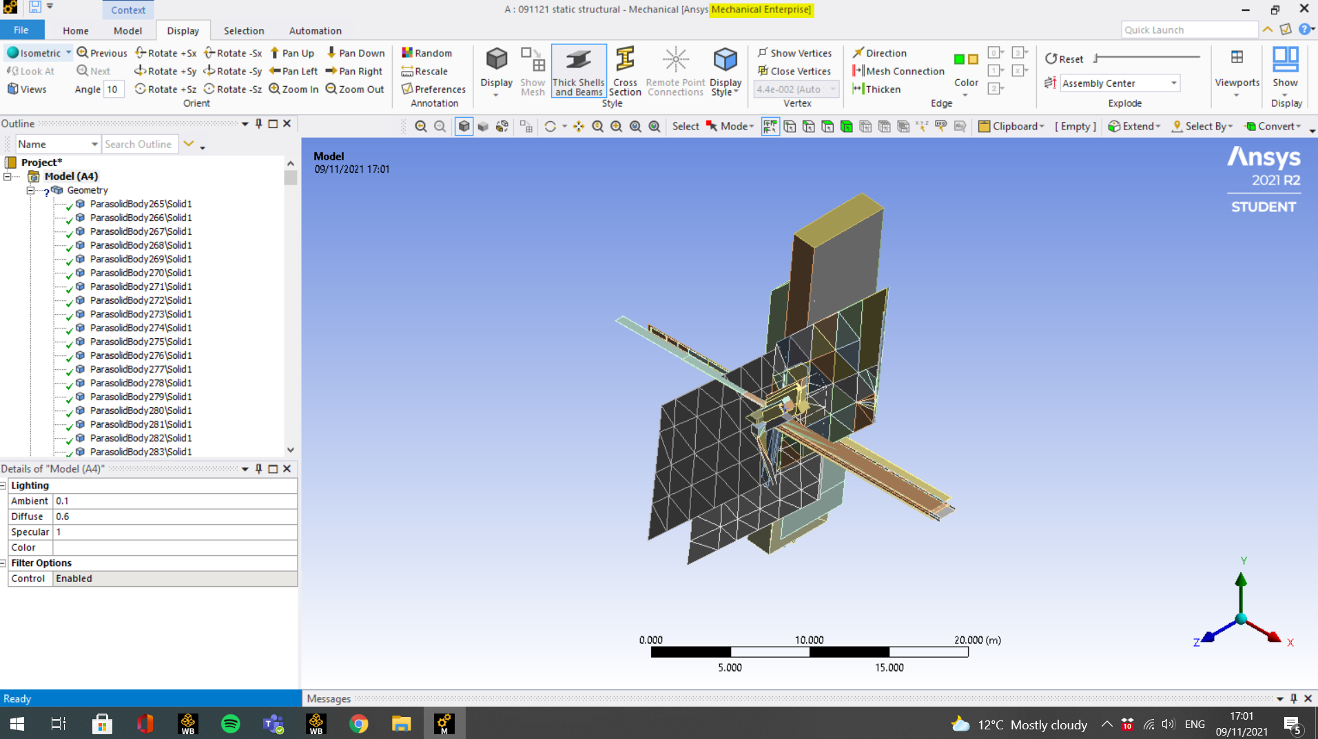

      I have a problem with the geometry of a bridge being opened in the Mechanical model.

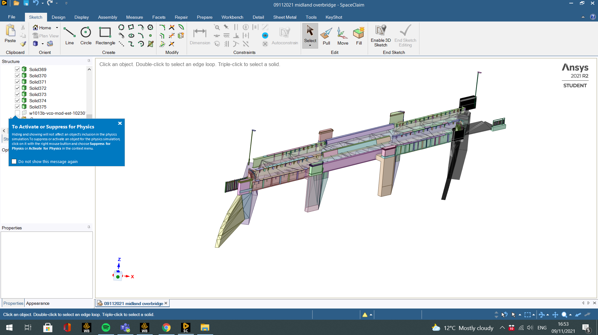

      Initially I opened the Autocad file in SpaceClaim without problems, all the solids are in there . But when I open Model in Static Structural, the bridge is totally distorted.
      I have installed Ansys 2021 R2 Student Version.
      Is the geometry too complex to be opened in SpaceClaim and transferred to the Mechanical model? Should I install a non student versions?
