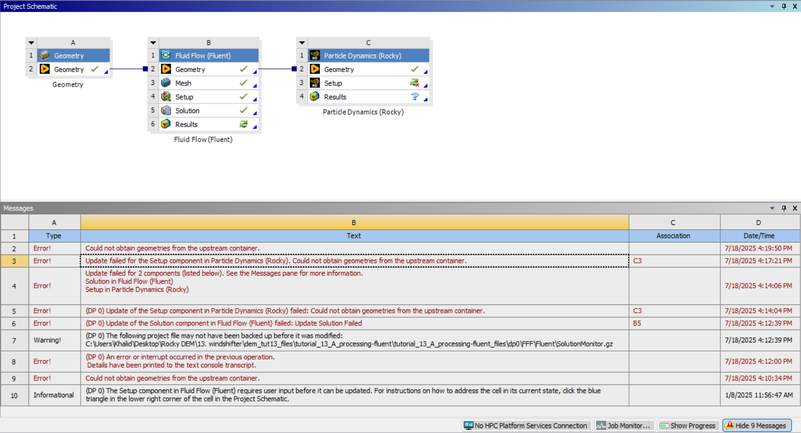

      I was following the tutorial no. 13 from the tutorials provided by Ansys. It was a fluent, rocky, coupled simulation. In Workbench, I imported a .dsco file in geometry. Connected it with Fluent through Workbench. solved it in Fluent. Then connected the geometry of Fluent with Rocky. A line that indicates a link in the workbench was shown between rocky geometry and fluent geometry. There was a green tick beside all the geometries. But after double-clicking setup, when Rocky opened, I couldn't find anything under geometry. Though a message was shown that geometry was being imported from upstream, nothing was finally shown.

      I have found that my rocky is not failing with that specific file only. Any model I am doing in Ansys Discovery is not being imported to Rocky. I was trying one of my own  model using Discovery, to perform parametric optimization through rocky.

          All 2025 R2. But not working with Rocy. Though working with fluent and mechanical. I have tried by uninstalling and reinstalling. This problem was also in R1.
