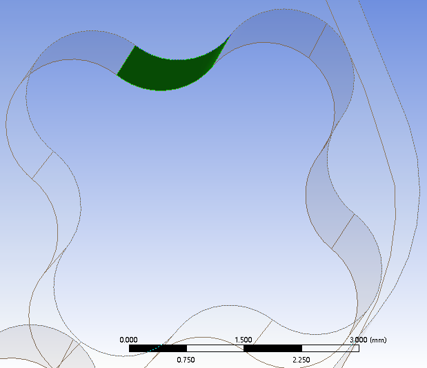

      I want to use "merge" to merge inside faces together. It performs successfully but it causes my geometry distortion. The geometry that before performing "merge" is showing below.

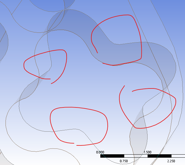

      After perfoming "merge", it becomes like that. As you can see, the curves are greatly changed.

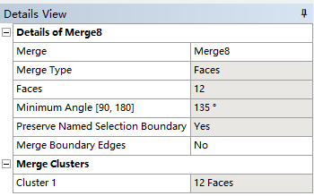

      And the settings are showing below.

    • Keyur Kanade
      Merging faces at geometry level in DM is not recommended. If these faces are not giving any problem in meshing, you can leave them as they are.
      Also if you want to have then single name then please use Named Selection.
      Keyur
