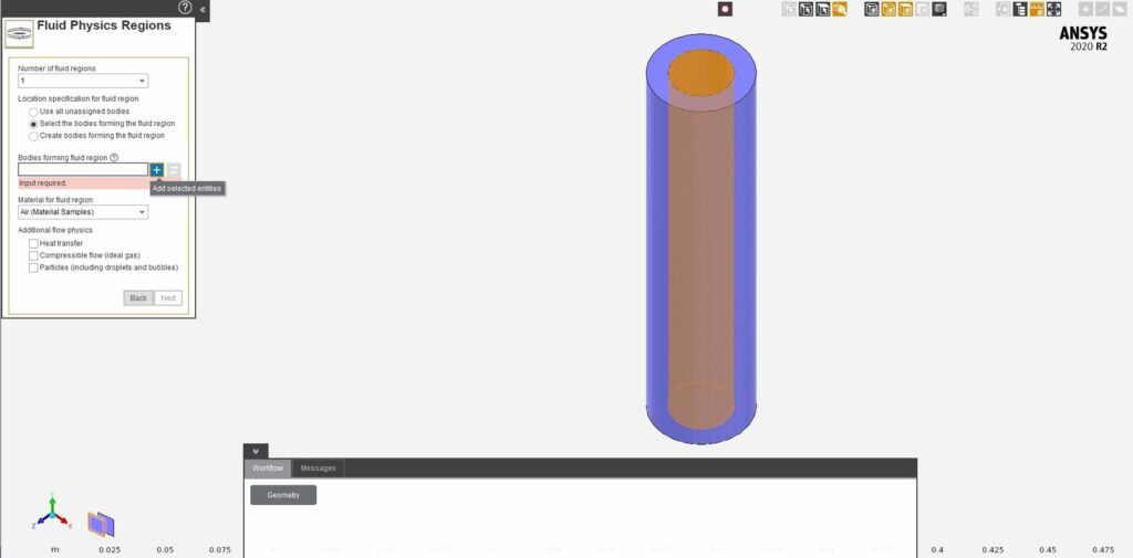

I have a fluid flow simulation, and I am using Discovery AIM. It is about the fluid flow in the battery lid. As the geometry is too complicated, I wanted to ask if it is possible to use only the fluid region part in the simulation?
Many thanks for your support,
Farnaz -
February 3, 2021 at 7:49 am
February 3, 2021 at 8:32 am
farnazhd66
SubscriberThanks, but my question is, does it make sense, if from the beginning, only the fluid region part is imported to the simulation(not the whole geometry.)
Like In your example, can I import just the orange part as the whole geometry?
February 15, 2021 at 8:15 am
Charudatta Bandgar
SubscriberYes farnazhd66Â
The way I mentioned is the way you can start with fluid, please try it.
