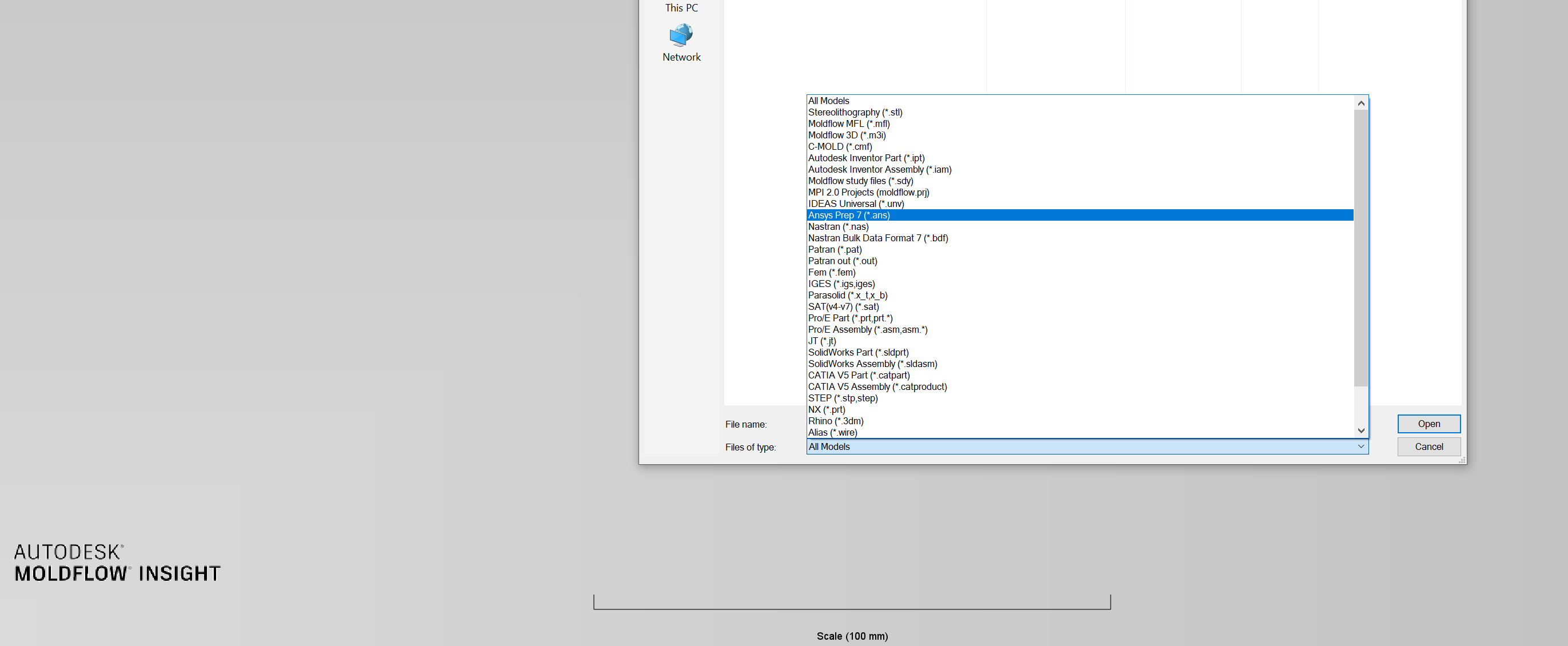

        Moldflow Insight has an import option called “Ansys PREP7 (.ans) ” and
        I don’t know how to get such an extension from Ansys workbench.
        I need the tetrahedral mesh that I create in Ansys (with it’s nodes I think)
        to import in moldflow to analyze it.
        I attach a picture of all options that moldflow gives for importing geometry.
        May you help me on this?

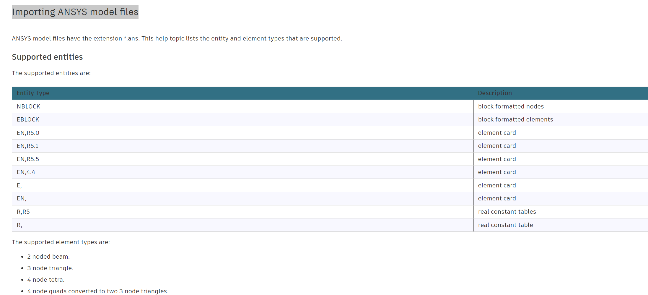

      • Fardin Naqizade
        I aslo attach moldflow help about the entity types that it supports
        (which I don't understand what they are! ?)
        But it is clearly telling that it is capable of importing tetrahedral mesh
        from Ansys.

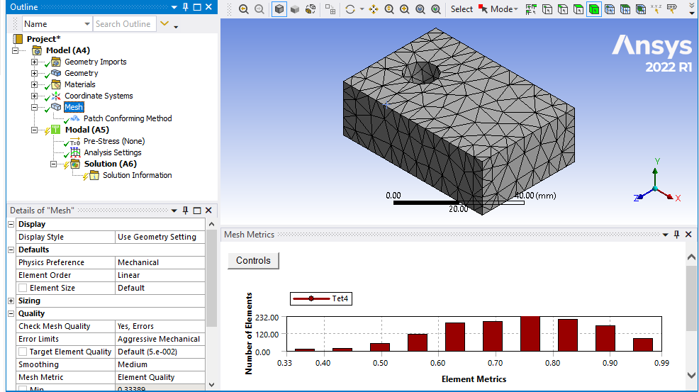

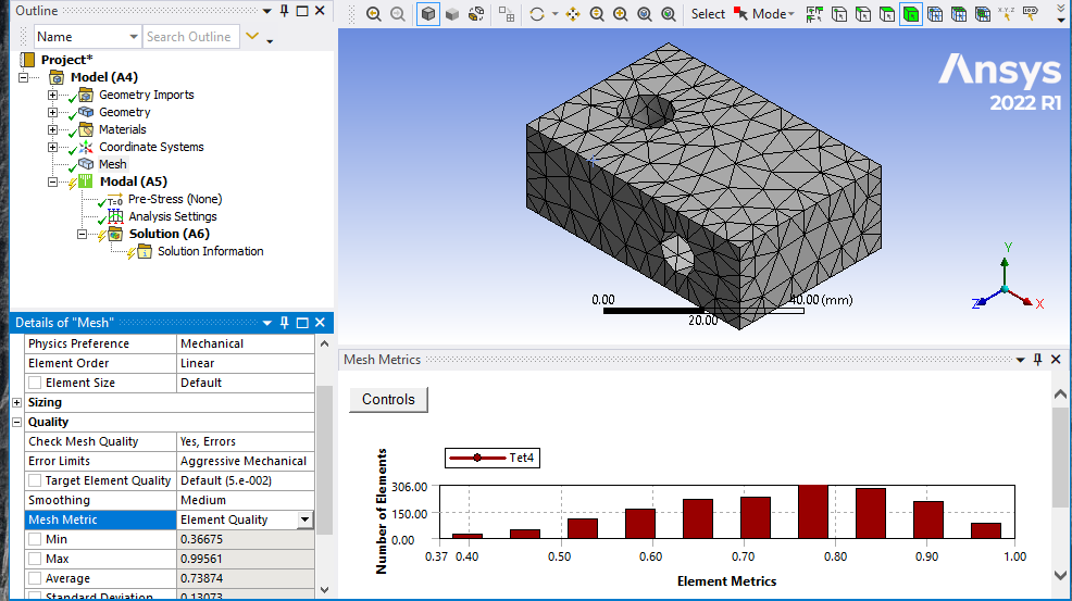

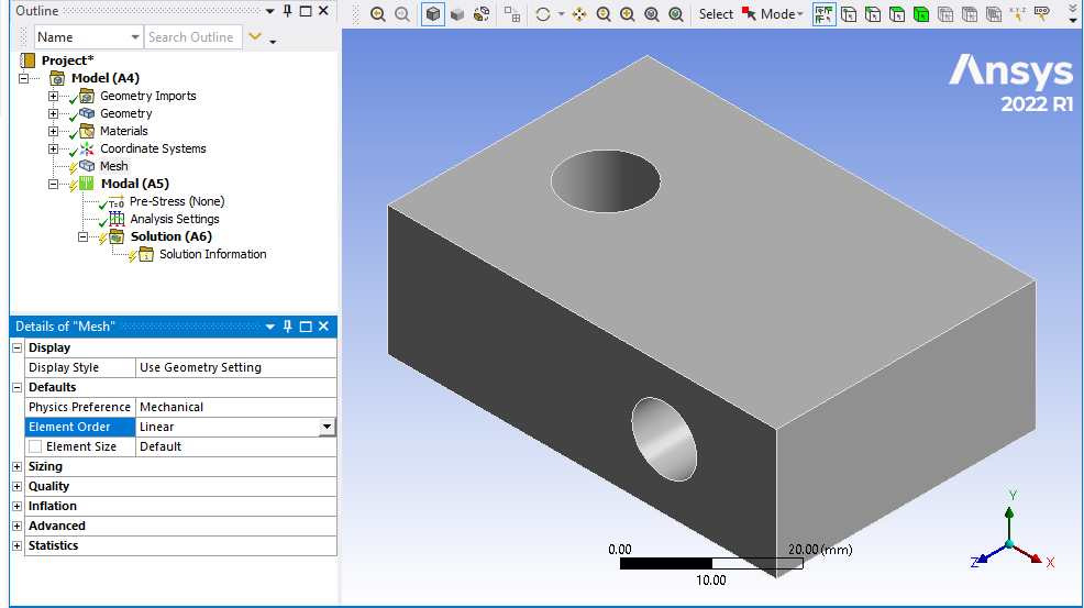

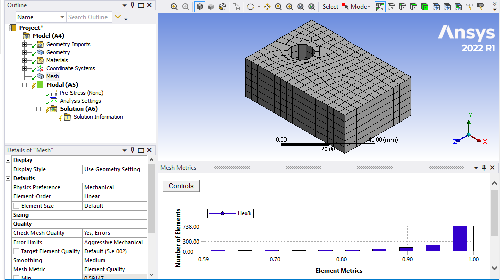

      It’s not any tetrahedral mesh, only a 4 node tet element. By default, Ansys will create a 10 node tet. You must change the Element Order to Linear on the Mesh to get a 4 node tet.
      Complex shapes should deliver pure tet elements. You can turn on Mesh Quality metric to see that there are only tet elements.
      Simpler shapes may generate Hex elements.

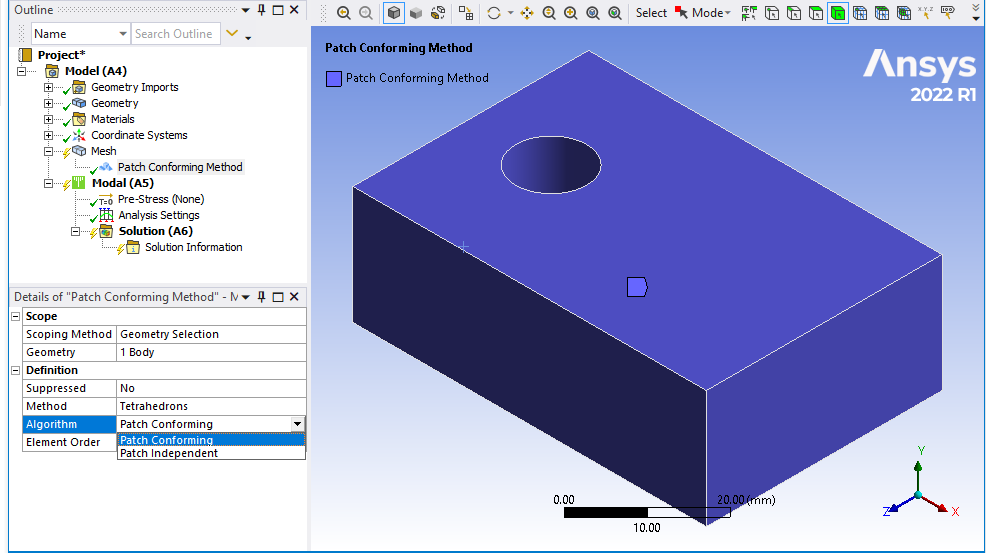

      Insert a Mesh Method and select the body to force the mesh to be Tet elements. Note that there are two choices for Algorithm.  Patch conforming forces the mesher to follow the edges of every face. Patch Independent allows the mesher to ignore some of face edges and generally results in fewer and better quality elements.

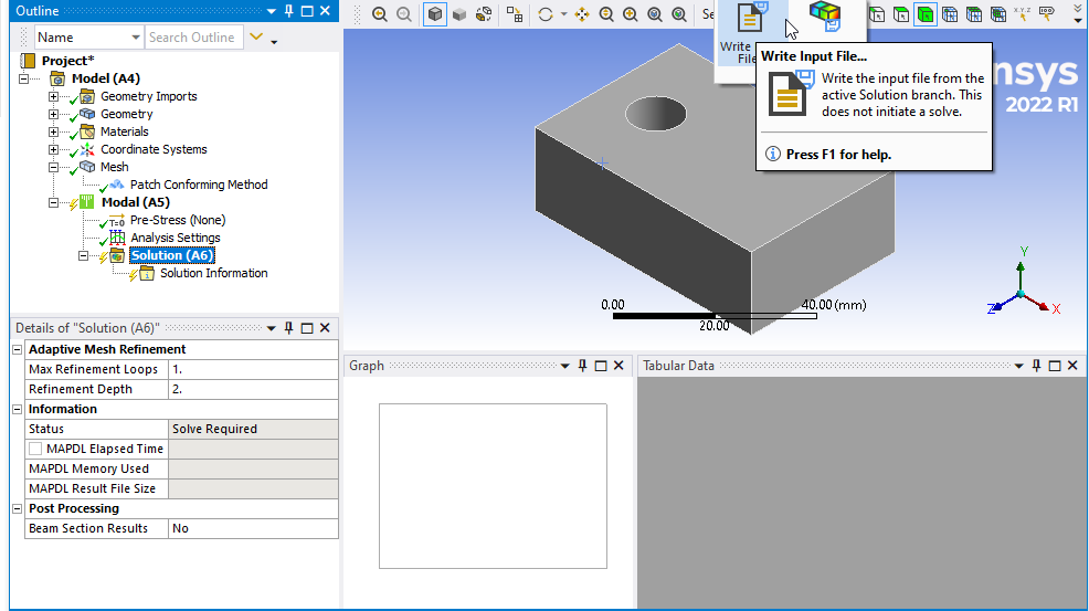

      I used a Modal anlysis to mesh this and when I click on the Solution branch in the outline, I can click the Write Input File in the Tool section of the ribbon.
      Ansys offers a choice of file extensions, either .dat or .inp but both give the same content. You can rename the file to .ans after it is written.

      I did as you said and now I have a .dat file that when I open
      as text file I see the nodes data there,but when I change the
      extension and import it into Moldflow Insight for some reason
      it can’t load the geometry,
