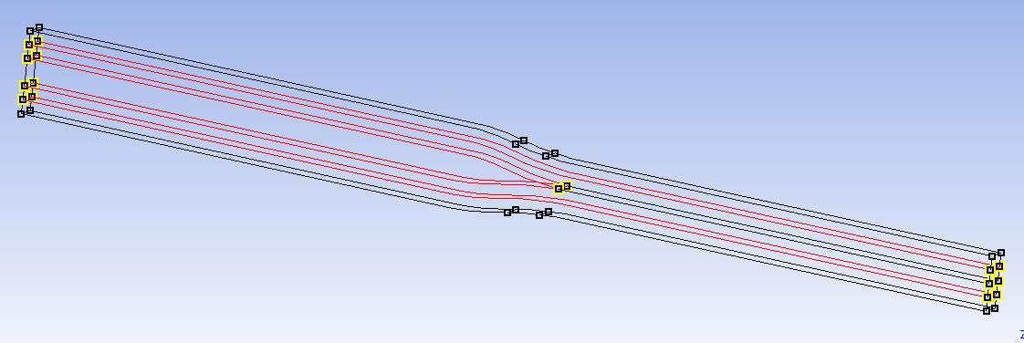

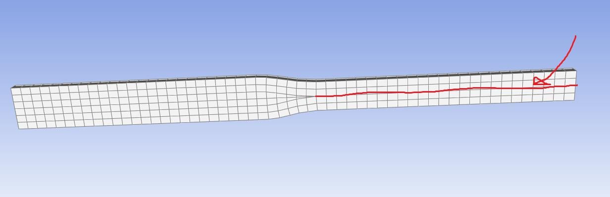

I'm trying to use ACP (pre) to generate a composite solid model containing a drop in the middle but I'm facing a problem when generating the interface layer after the drop. I keep getting this message:Â
"Found 50 Interface Elements which are not surrounded by structural elements"Â
So the elements are not being generated properly at the place shown in the next pics:Â
I need a way to generate an interface in ACP pre or maybe some way to do it manually after exporting to modeling phase.
The project file is attached.Â
