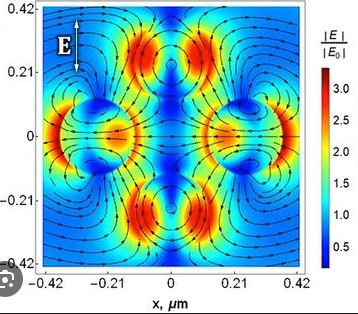

    • sagar
      How to generate electric and magnetic field profiles along with the vector direction like this in Lumerical

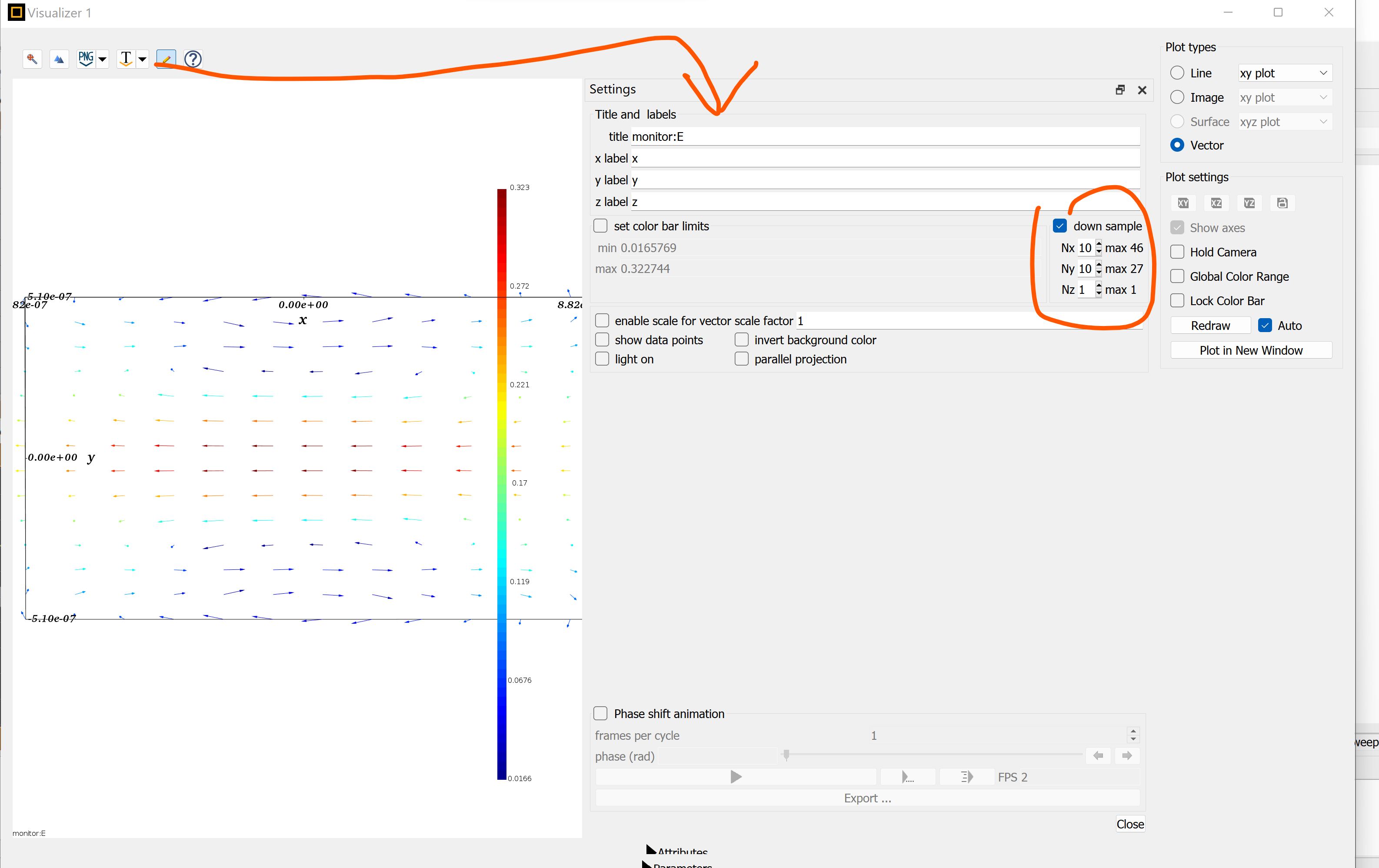

    • Guilin Sun
      You can use
      1: the visualizer and choose "vectorial plot"
      2: use script vectorplot  https://optics.ansys.com/hc/en-us/articles/360034410614-vectorplot-Script-command
      you can use setploy to modify the plot settings, such as Nx,Ny, scale etc
      3: matlab https://optics.ansys.com/hc/en-us/articles/360034404034-Creating-vector-plots-with-MATLAB
