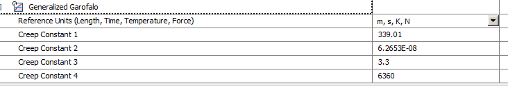

I would like to model a solder creep behaviour using generalized garofalo law in ANSYS Engineering Data. I saw that there are a total of 4 creep constants are needed for this law. I managed to obtain those parameters in scientific papers as attached.
However, the reference unit in ANSYS Generalized Garofalo seems not align with the paper. May I ask had I inputted the creep constants correctly? This is because the solver would produce error after I run my simulation with the current input.

Ansys EmployeeC2 should be in units of pressure consistent with m, s, K, N. So Pa and not MPa. I imagine though if your model is more naturally on the mm scale and not meter, then you may want to change the Reference Units...is 'Table III' from the reference paper? If so then change the reference units to mm, s, tonne, etc. Would need to redo the curve fitting otherwise (I imagine).

Thank you for your response. Yes, table III is from reference paper. As can be seen, the C2 is in the unit of MPa^-1. If I am using m, s, K, N reference unit in ANSYS, I have inputted C2 as 6.2653E-8 as Pa^-1 instead of 0.062653 MPa^-1.
May I know is that correct?

Ansys Employeegenerally speaking no. To be absolutely correct I'd rather see you perform the curve fitting with the data in the units that you need. Especially when the creep equation has a term like stress to some power. However I think in this case it should be fine as C2*Sigma will be unitless. Does that paper contain any test data for the material?
