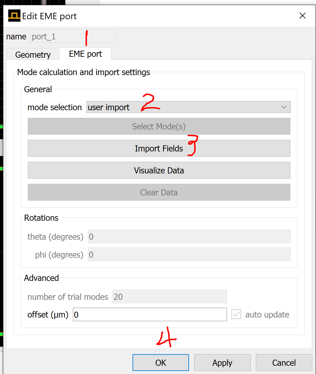

October 8, 2021 at 3:15 pmOctober 9, 2021 at 2:01 pmiqnlo
SubscriberThank you so much for your reply.
When I click the user import button, a window pop up and ask me to upload something. May I know where shall I download the field file? Thank you!
October 13, 2021 at 3:41 pmGuilin Sun
Ansys EmployeeBecause you want to import Gaussian source, you should have your own data. you can also use script to generate the beam.

October 20, 2021 at 10:09 pmGuilin Sun
Ansys EmployeePlease check videos and applications
Optical Sources - Import Source - Physics & Applications
Optical Sources - Import Source - Setup & Tips
Importing arbitrary source fields into EME ports
Using an equation to define the spatial field profile of a source in FDTD It has the scalar Guassian beam. You can also use NA beam source in FDTD, with a monitor one cell away to get the data, and import it: Using monitor data to define the spatial field profile of a source in FDTD
