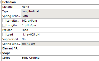

      I am trying to simulate a preloaded compression spring with body-ground connection. Can I know how does the spring length affects the simulation? The spring stiffness and preload force is predefined. Please see the setting below:

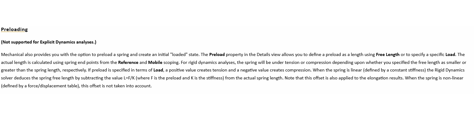

      Please refer to this help documentation which explains the role of spring length in preloading:
      Springs (ansys.com)
      Regards Vinayak

      Hi Vinayak According to the help documentation, the free length only matters for "Rigid dynamic" analyses? In Static Structural, it should not affect the spring stiffness? As long as I have sufficient free length for the deformation, the preloading force will change linearly regardless of the free length of the spring right?
