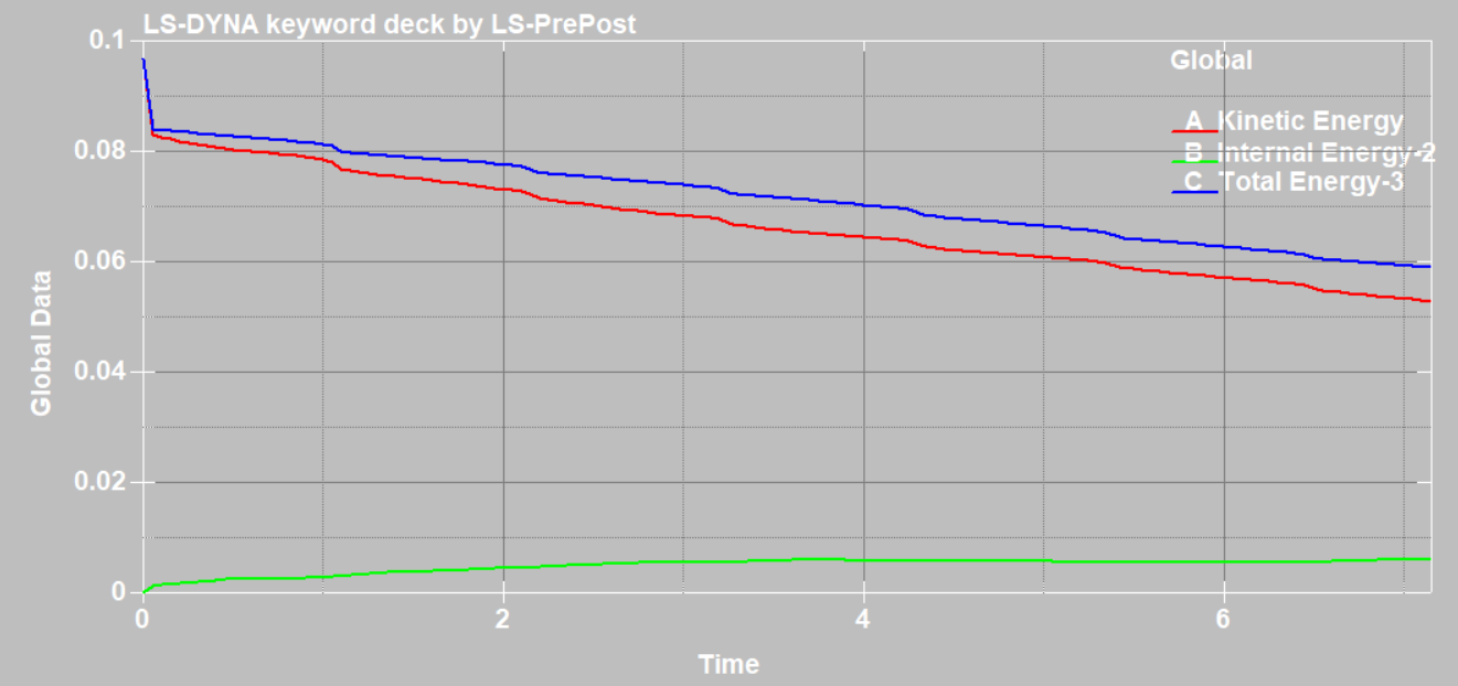

      I am trying to implement the ALE method for an analysis of a section of a hull impacting the water.
      I managed to create the model and run the analysis.
      I don't understand why there is such a significant loss of energy during impact. In similar models using the SPH method, I had a maximum loss of 10% of the initial energy, but in this model it is almost halved.
      I have already tried using both SOLID and SHELL elements with different materials, ELASTIC, RIGID, COMPOSITE... but the result is always similar.
      Currently, in the model, I have defined a water tank with EOS_GRUNEISEN and the upper air with MAT_VOID.
      Is it normal for such a high loss to occur, or is it necessary to implement other KEYWORDS?
      Thank you in advance.
      Energy plot
