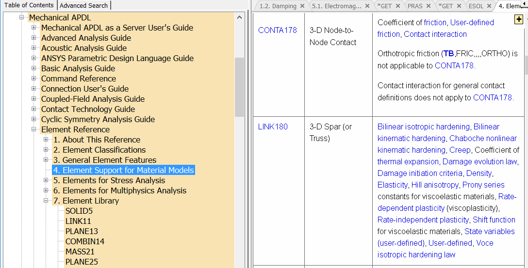

      Forgive me if I am misinterpreting your request, but it sounds like you want to be able to simulate the GFRP rebar rupture when the rebar stress exceeds 970 MPa. Presumably, at rupture, you would like the LINK180 to stop transmitting force, so a bilinear stress-strain curve with near-zero plastic slope would not be appropriate (the element would still transmit force when operating in the plastic portion of the curve).

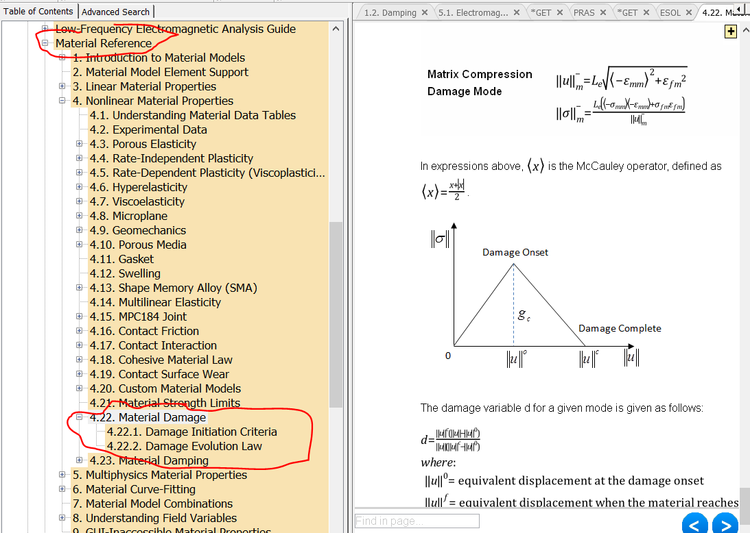

      It appears that LINK180 does support the damage evolution law and damage initiation criteria:
      I've never used these material models with LINK180 so cannot provide details on setup, but maybe if you review the Help section on Material Damage you can figure out how to define it for use in your model:
      Kind regards,
      Bill
